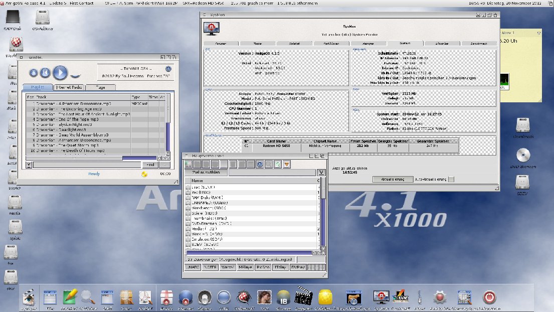

Thank nbache for your test,
I reupload a new picture
http://zzd10h.amiga-ng.org/X1000/Glitches_TuneNet.jpg
showing
1) TuneNet problem : Notice the half displayed Fast Forward button
2) AmiPDF problem : 2 AmiPDF windows opened,
-in the background the buttons are OK, (edit : no, the Select button is bad)
-in the foreground the Print,zoom, last and first page are bad displayed.
If it was a palette problem, all the same buttons will be bad, no ?
I understand easily that Amigakit can't test all the programs (and many times in this cases are neccessarily to discover this problem).

It would help if you go into GUI Prefs, effects & turn off "window transparency, all 3 sliders. Hard to tell/see what you're fighting, could be something other then your gfx card.zzd10h wrote: I reupload a new picture
Ken
Re: X1000 : graphical glitches with HD5450
Hi,
I have tried this but without success, same problem
I have tried to disable transparency with and without 3D acceleration.
Of course, between each test, I have rebooted the x1000.
See grab :
http://zzd10h.amiga-ng.org/X1000/Glitches_GUI.jpg
Thank for the suggestion
See grab :
I'd like to add that I also have gfx glitches, but with my HD6570 card. My problem is disappearing or partially drawn drop-shadows around windows. Sometime drop-shadows are drawn correctly, but sometimes they are only draw at the corners and sometimes they just disappear from a random window while doing something in another window. Never saw this with the R9250 on the XE.

Hi all.
I have here similar glitches with my X1000
and a 5450.
On a AmigaOne500 with this card there are the
same glitches.
Interresting, I'm not alone
Do you have problem, too, with Dopus, Ranger, window's shadow, amiPDF... ?
Therefore
1) we 2 have no luck with bad 5450
2) our cards a little bit different than Hans, nbache and Trevor ones
3) our x1000 are different than betatester
4) the drivers in particular situations have a little problem
@zzd10h
Must take a look into it.
Dopus i can say has no problems.
Filer shows the most problems with the icons on the top.
Trained my memory a little to find always the right click.
I tested earlier the Radeon HD4650 from my sold AmigaOne500 in the X1000
and vice versa the 5450 in the AmigaOne500. The glitches was also
on the AmigaOne500 so not specific X1000 problem i guess.
With the 4650 there are on both machines no glitches.
@TearsOfMe:
The problem on Dopus is just the little arrows, near the center at bottom of lister.
These arrows are half drawed, not a big problem.
It's must be hard to use filer and dangerous, no ? Oups, this button was "Delete"
@zzd10h
Ok i have looked at DOpus and the arrows are not correct drawed.
Mostly i use the user buttons in filer and for other stuff DOpus.
Hope the bounty for Magellan will soon reached. Miss it much.
