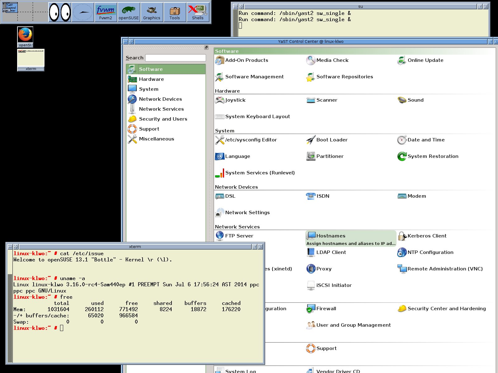

Kernel 3.16.0-rc4 for the Sam440ep( Flex): Sam440ep-3.16-rc4.tar.gz
Kernel 3.16.0-rc4 for the Sam460ex( Lite): Sam460ex-3.16-rc4.tar.gz
Kernel 3.15.4 for the Sam440ep( Flex): Sam440ep-3.15.4.tar.gz
Kernel 3.15.4 for the Sam460ex( Lite): Sam460ex-3.15.4.tar.gz
The RC 4 runs fine with openSUSE 13.1 on my Sam440ep-Flex (ATi Radeon 9250 PCI).
