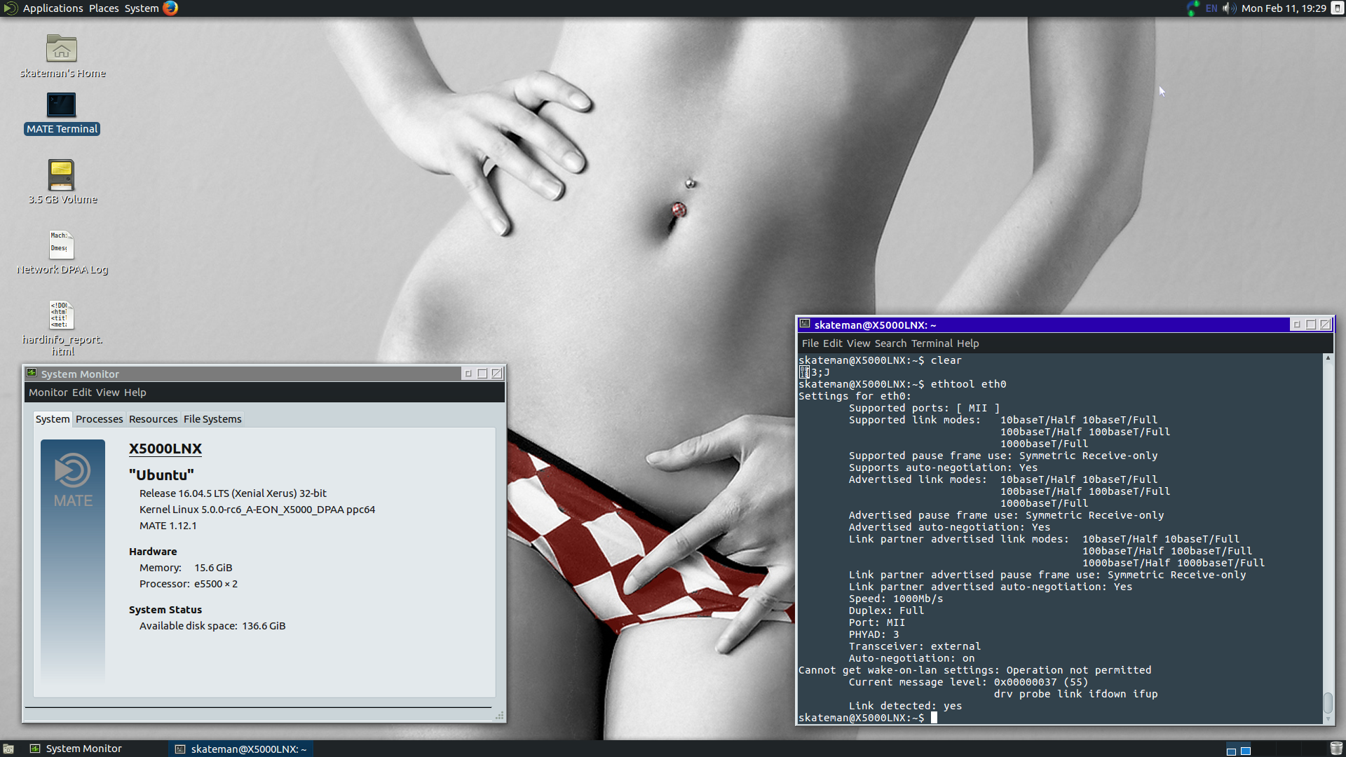

Kernel 5.0 RC6 dpaa patched is running fine on the AmigaOne X5000 but the network issues remain... (thanks anyway guys!! )
I had to unplug and reinsert the ethernet cable to get the network interface going... and did get an ip address by DHCP.
But soon after that, the network traffic died...like it almost always does.
Big picture http://www.skateman.nl/wp-content/uploa ... 192904.png

Skateman wrote:Kernel 5.0 RC6 dpaa patched is running fine on the AmigaOne X5000 but the network issues remain... (thanks anyway guys!! )
It's better than it was, I can now ping various machines on my local network, and I did get a couple of web pages to load at one point.
I am fairly sure that this is a memory issue, as you've seen, it works for a short time then dies. I will have to take a look and see if there is anymore initialisation code in the pamu driver I need to port across.
This code I'm adding is from the SDK Linux version of the driver, I suspect it wasn't ported to mainline due to updates made to U-Boot, and I think we'll get told to update U-Boot if we try to get this code added. Feel free to hassle Matthew (AmigaKit) about this :)
Where did you find your backdrop?
Regards
Darren
OK. Maybe Darren can solve the issue.
Regards
Darren
Hi Darren,
For the backdrops, go to this website. http://www.amiga-look.org/category/backdrops
Regarding the DPAA ethernet issues i think we are at the state of March 2018. I have a video from March 2018 regarding the ethernet traffic as can be seen here https://drive.google.com/file/d/15I5TDQ ... sp=sharing
Back then several tools like MII-TOOL did work, and have also stopped working a while ago.
would be great if we can figure this out!
Dave
