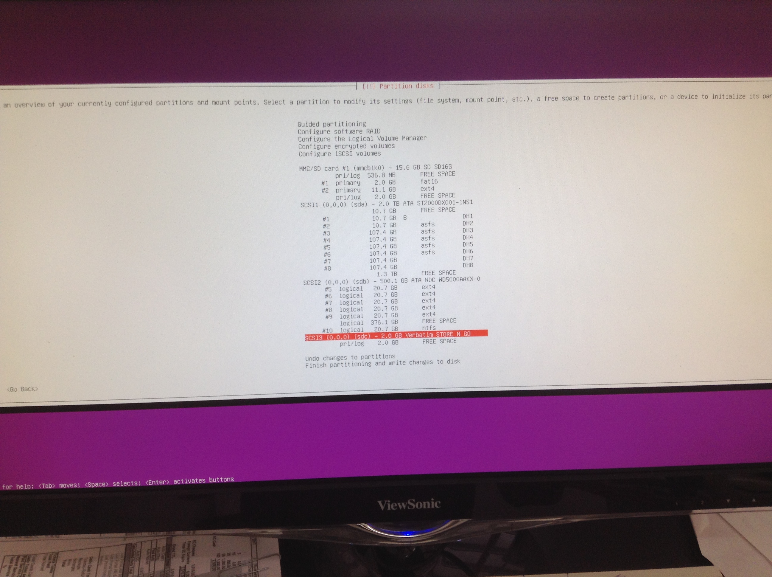

Spectre660 wrote:edit the bootargs variable
and adjust the /dev/sdb3 to point to your installation partition as noted above using:
How will I know what drive partition the installation uses?
Is it going to be a partition on my hard disk or the USB drive?
Sorry for the dumb questions but I don't want to mess this up.

Re: Spectre660's Linux downloads for the X5000
Select the Manual option and it will let you decide .
xenic
Posts: 1185
Post by xenic »
Spectre660 wrote:Select the Manual option and it will let you decide .
O.K. thanks. In your screengrab I see partition numbers. Do the partition numbers start at 0 or 1? In other words is it "partition0, partition1,partition2 etc." or "partition1, partition2,partition3 etc.".
Posts: 1538
This first screen grab shows a mixture of options. Both Partitions and the entire drive drives .
The next Screen after the Manual Selection shows the drives and the individual partitions .
The USB drives appear last in the list of devices .
