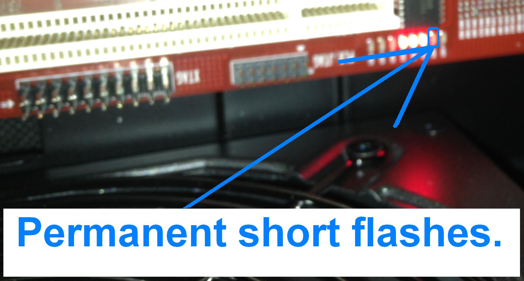

Unfortunately your steps didn't help. :( When the X1000 doesn't boot then the forth LED flashes (on the right side next to the three activ LEDs) shortly and permanent.
(120.48 KiB) Downloaded 736 times
The LED of the internal network chip flashes also in the same time shortly and permanent.

OK, I think it has sometimes a CPU core supply fault.

Postby LyleHaze » Mon Feb 18, 2013 11:30 pm
Just for the record: TRM 1.5 Page 18, Table 9 says there are 6 LEDs.. There are in fact 8.
Also, for those with less than perfect eyesight, With the board mounted in the factory case,
the LED's are numbered from LED8 on the left to LED1 on the right side.
LED8 and LED7 are driven from each core of Xena, and will glow slightly when Xena is in idle_reset state.
If you will look to the right..
LED1 is labeled "General Power Supply Fault"
LED2 is labeled "CPU Core Supply Fault"
When the X1000 doesn't boot then the LED2 lit on in regular short intervals.
