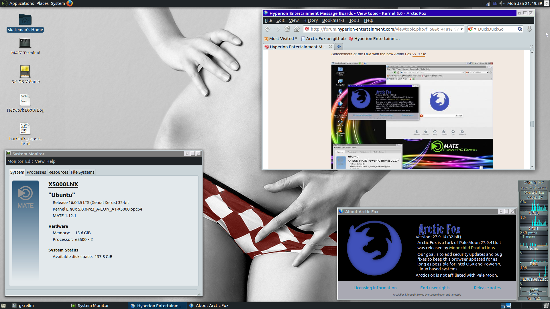

Kernel 5 RC3 running fine on the AmigaOne X5000.
Big picture http://www.skateman.nl/wp-content/uploa ... 193937.png

Skateman wrote:Kernel 5 RC3 running fine on the AmigaOne X5000.
Many thanks for testing the RC3 of kernel 5.0 and thanks a lot for testing the new version of Arctic Fox.
Nice screenshot. :-)
— Christian
Posts: 967
Re: Kernel 5.0
— Christian
Your welcome!
And for those interested, i found these backdrops on http://amiga-look.org/category/backdrops :-)
