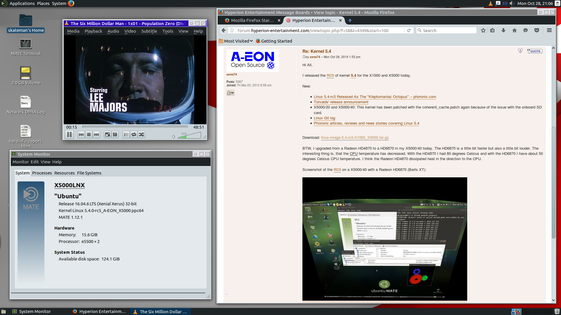

I released the RC5 of kernel 5.4 for the X1000 and X5000 today.
Download: linux-image-5.4-rc5-X1000_X5000.tar.gz
BTW, I upgraded from a Radeon HD4870 to a HD6870 in my X5000/40 today. The HD6870 is a little bit faster but also a little bit louder. The interesting thing is, that the CPU temperature has decreased. With the HD4870 I had 80 degrees Celsius and with the HD6870 I have about 50 degrees Celsius CPU temperature. I think the Radeon HD4870 dissipated heat in the direction to the CPU.
Screenshot of the RC5 on a X5000/40 with a Radeon HD6870 (Barts XT):

Kernel 5.4 RC5 running fine on the AmigaOne X5000
Big picture http://www.skateman.nl/wp-content/uploa ... 210620.png

Thanks a lot for testing the RC5!

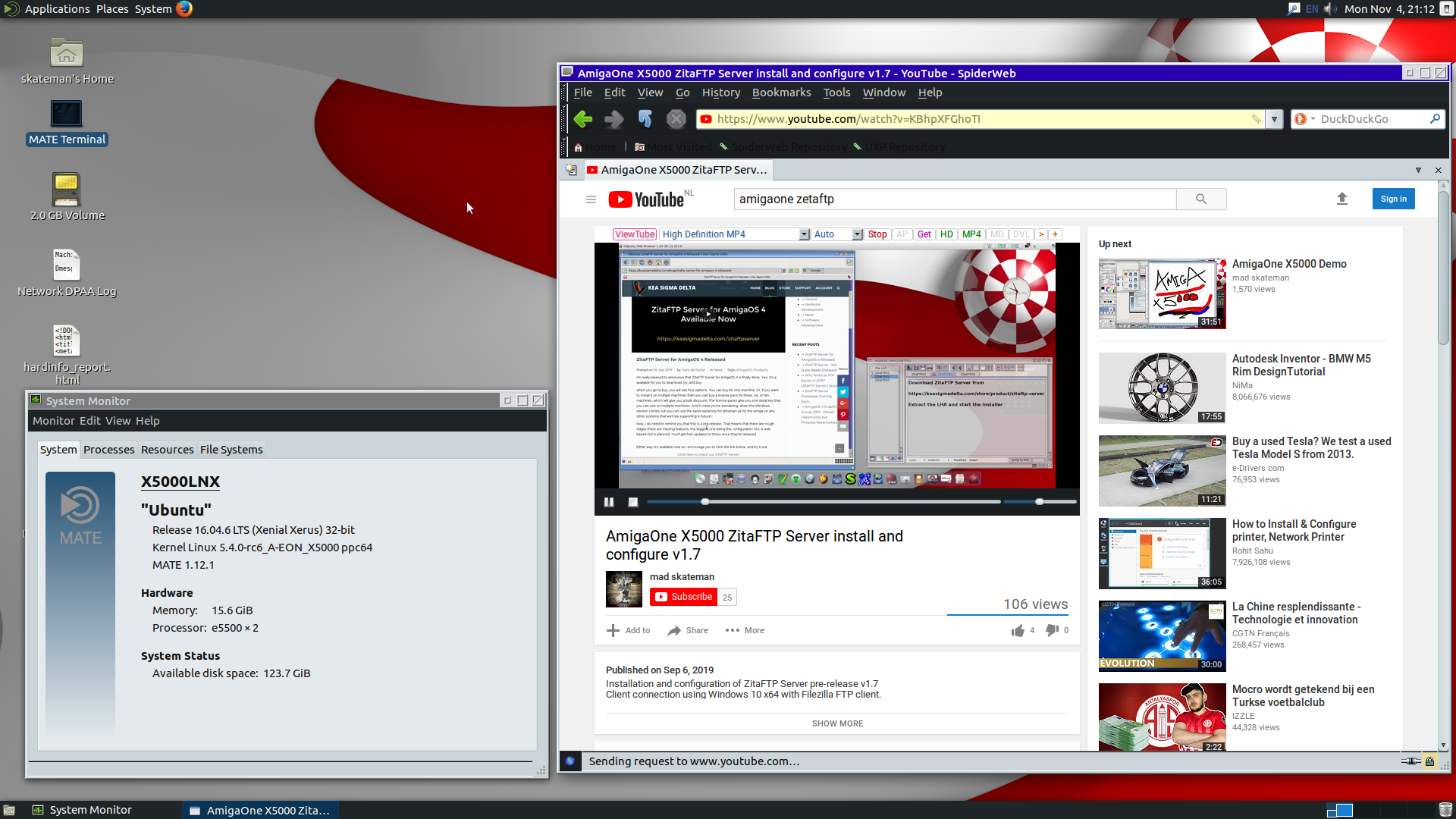

Kernel 5.4 RC6 running fine on the AmigaOne X5000
Also running Spiderweb with ViewTube plugin for HD video.
Big picture http://www.skateman.nl/wp-content/uploa ... 211205.png

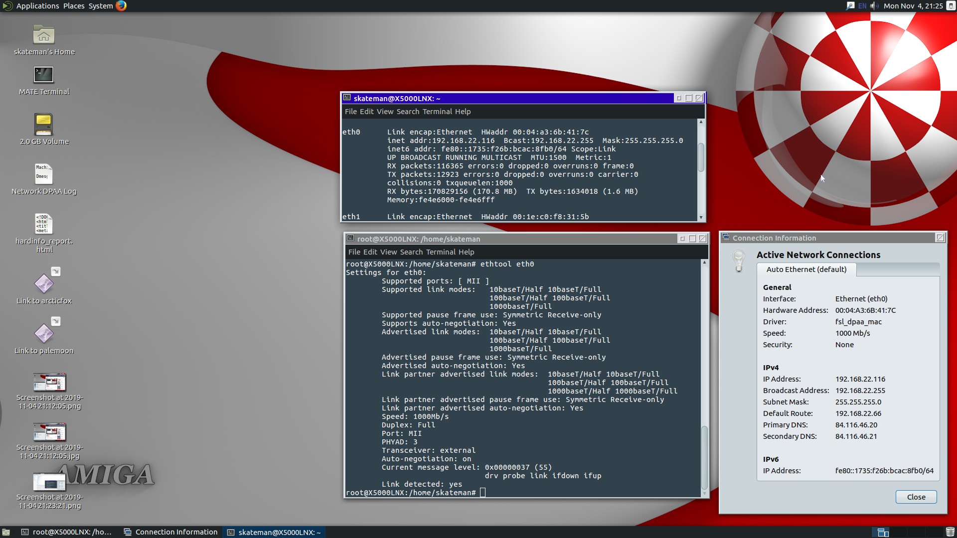

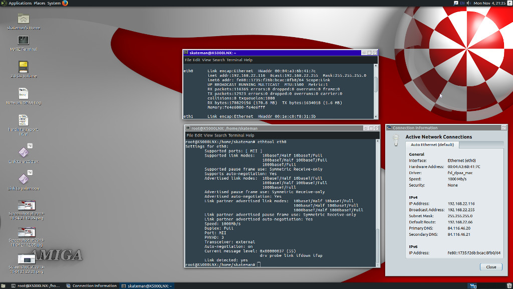

Network improvements... I managed to get around 170MB flowing through the DPAA X5000 onboard ethernet adapter before all traffic died... (which is much better than the previous kernels, but it is still broken)
Big picture http://www.skateman.nl/wp-content/uploa ... 212550.png

Skateman wrote:Kernel 5.4 RC6 running fine on the AmigaOne X5000
Thanks a lot for all tests you have done! :-)
