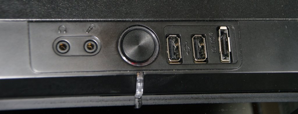

mbrantley wrote:It looks like the newer Fractal Design cases, including the one used for my June 1200 X1000, has a USB3 socket instead of an eSATA socket. On my machine I don't think the USB3 socket is connected to anything (haven't checked) but the other two ports are.
To tell the truth, I am not sure what an eSATA port looks like, as I have never used one. So, my X1000 case might also have the same USB3 port that yours has, which is not connected to anything yet.
It does look like an USB port and a regular USB cable connector can fit into the port, but the port has a different colored center section, so maybe mine is the same as yours and I mistakenly assumed I had the same eSATA port that another user mentioned he has on his X1000 case next to the two USB2.0 ports on the top, front of the case?
I originally thought it was a USB3.0 port until I read a post from another X1000 owner who called it an eSATA port, so I just played along with what he wrote. What ever it is, it is not hooked up to anything now, so it does not matter much.

If the port has blue insides it is USB3. I'm guessing at some point Fractal Design started supplying the cases this way. An eSATA socket looks different.
That was me, I think. I wasn't aware they changed it to USB.
Here's a picture of the top front of my X1000/Fractal case.
Taken from above
(136.4 KiB) Downloaded 1962 times

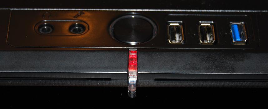

Here is the USB3 version..
USB3 on a X-case
(31.19 KiB) Downloaded 1954 times
I understand you can get a retrofit kit with ALL USB3 connectors now.

So my X1000 has the "blue" connector, hence is a USB3. What good is that to us? We don't have USB3, correct?

ggw wrote:So my X1000 has the "blue" connector, hence is a USB3. What good is that to us? We don't have USB3, correct?
Sirion with USB 3.0 support was already shown at Pianeta Amiga 2012 (see this thread on amigans.net f.e.). It's just not been released yet (i.e. still being worked on/beta tested).
If the X1000 doesn't have headers on the motherboard to connect the front USB3 ports to you might be able to get a USB3 PCI-E card that you can connect them to instead.
