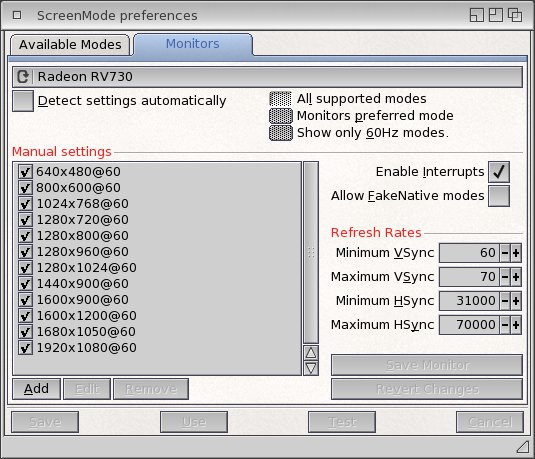

@AmigaDave
I can confrim that DVI works fine. I have my AmigaONE X1000 connected to a 24" BenQ wide screen monitor running ay 1920x1080x32 bit.
As I mentioned earlier, AmigaKit would have used a generic monitor setting when they installed AmigaOS 4.1.
If the automatic settings dosen't work with your Apple monitor then, as other have suggested you can manually edit your monitors refresh rates.
Look up your monitor manual (or check the tech spec on the web).
You will find that every monitor has its own frequency settings and an optimum recommended screen sizes.
e.g. The specifications for my BenQ monitor are:-
Screen Size 24.0"W
Optimum Resolution 1920x1080
Color 16.7 million
Horizontal Frequency 20 - 83 (KHz)
Vertical Frequency (Hz) 50 - 76 (Hz)
Therefore:
Vsync minimum = 50Hz
Vsync maximum =75Hz
Hsync minimum = 20000 Hz
Hsync maximum = 83000 Hz

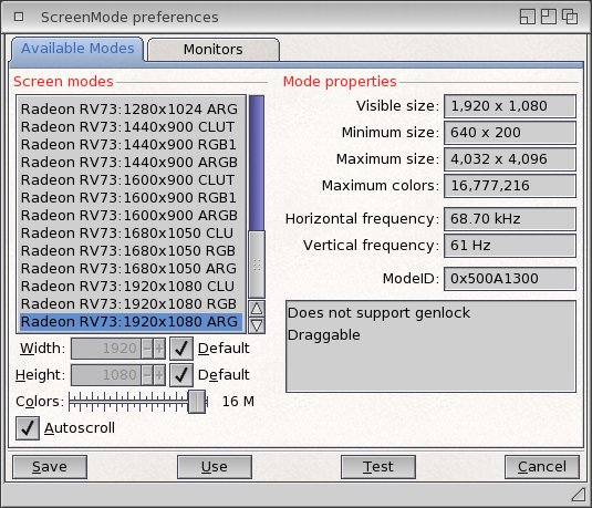

You can either edit the info in the Prefs/Screen Mode - Monitors . You can also manually add Screen resoutions, but to be honest I have not found this to be an issue with most of my monitors.
Screen Mode Preferences - Monitors
Screen Mode Preferences - Available Modes

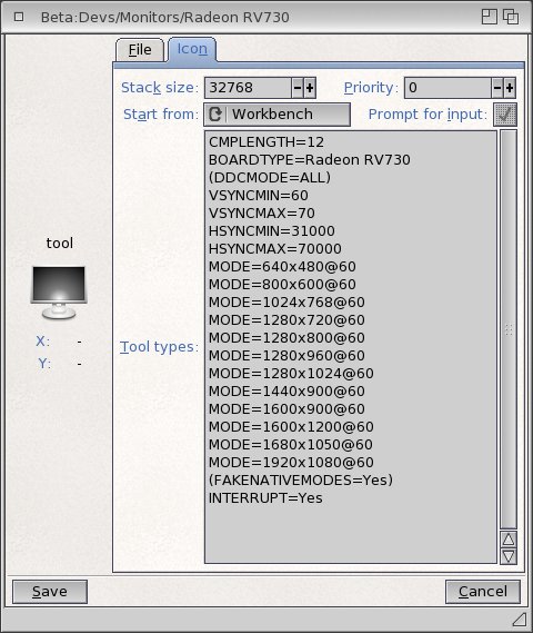

Or you can edit your Monitor icon "Tool Types" (Icon information) in Dev/Monitors/Radeon RV730
Monitor "Tool Types"

Dave, I believe all you need to do if the auto detect is not working is uncheck that box and set your own resolutions as Trevor noted.
Maybe a uncheck of the auto detect box the other selections will re-appear for you to choose and tweek to your monitors settings?
I know I had to play with mine a bit. Autodetect worked for me and it saw I could do the 1920 x 1080 so I went with it.
I think when I unchecked the box I then saw the original settings again and played with a 1600x1080 or something.

Yip, I was about to say the same thing (but I wanted to examine my setups first to verfiy) to salvage this situation.
Uncheck that option for "Detect settings automatically"
Go to you devs/monitors drawer and single click your Radeon AV790 (could be different number) icon with left button then hold down right mouse button and select information, enter the icon tab and just examine what is written there
I run all my Amigas in 1680x1050 so I hear ya ;)
Just add this line
MODE=1680x1050@60 (use 60 if the others listed use 60 otherwise use what has already been listed)
save and reboot and then go to your screen prefs and select it! I always use 16bit too but hey, that's personal choice
good luck but this should work - check out Trevors last picture insert to see exactly what is in there!
Here is my tooltypes, I decided to grab them
CMPLENGTH=12
BOARDTYPE=Radeon RV790
(DDCMODE=ALL)
VSYNCMIN=56
VSYNCMAX=60
HSYNCMIN=30000
HSYNCMAX=81000
