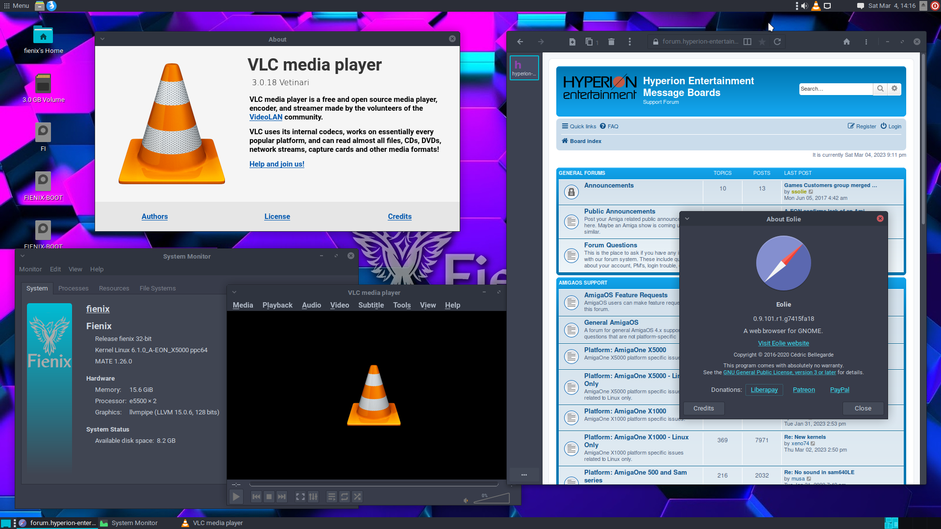

Fienix 6.0.1 up and running on my AmigaOne X5000
Big picture https://www.skateman.nl/wp-content/uplo ... -16-27.png
