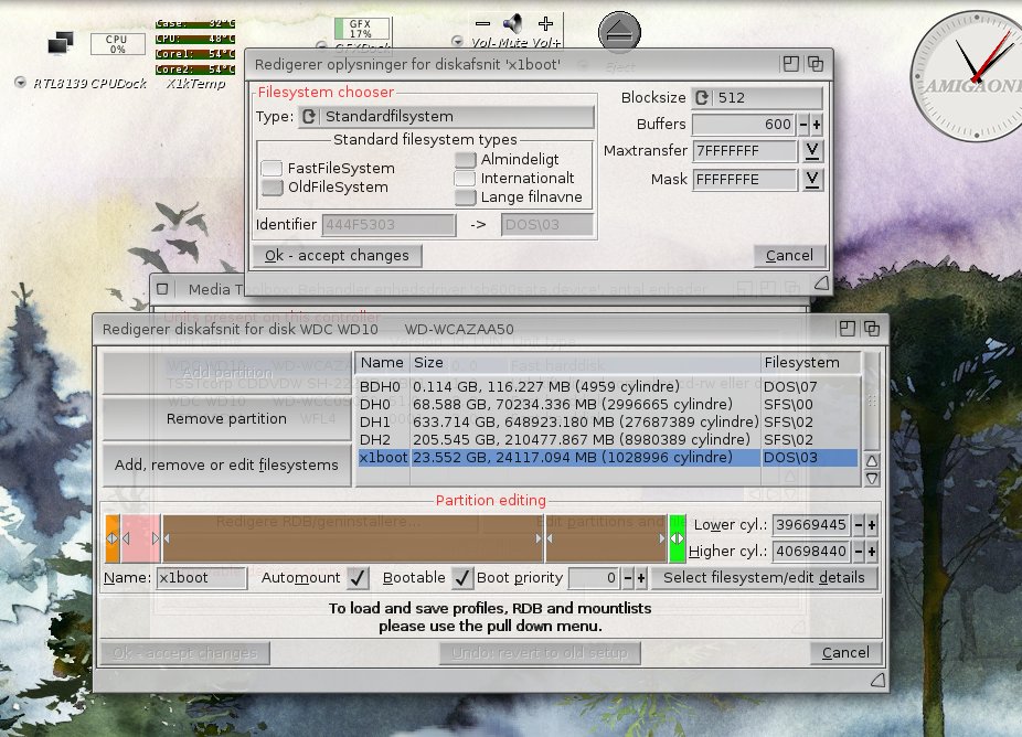

Re: Presenting the X1Boot Manager!
Hi Hypex
One more information
this is the setup of the my x1boot partition .
