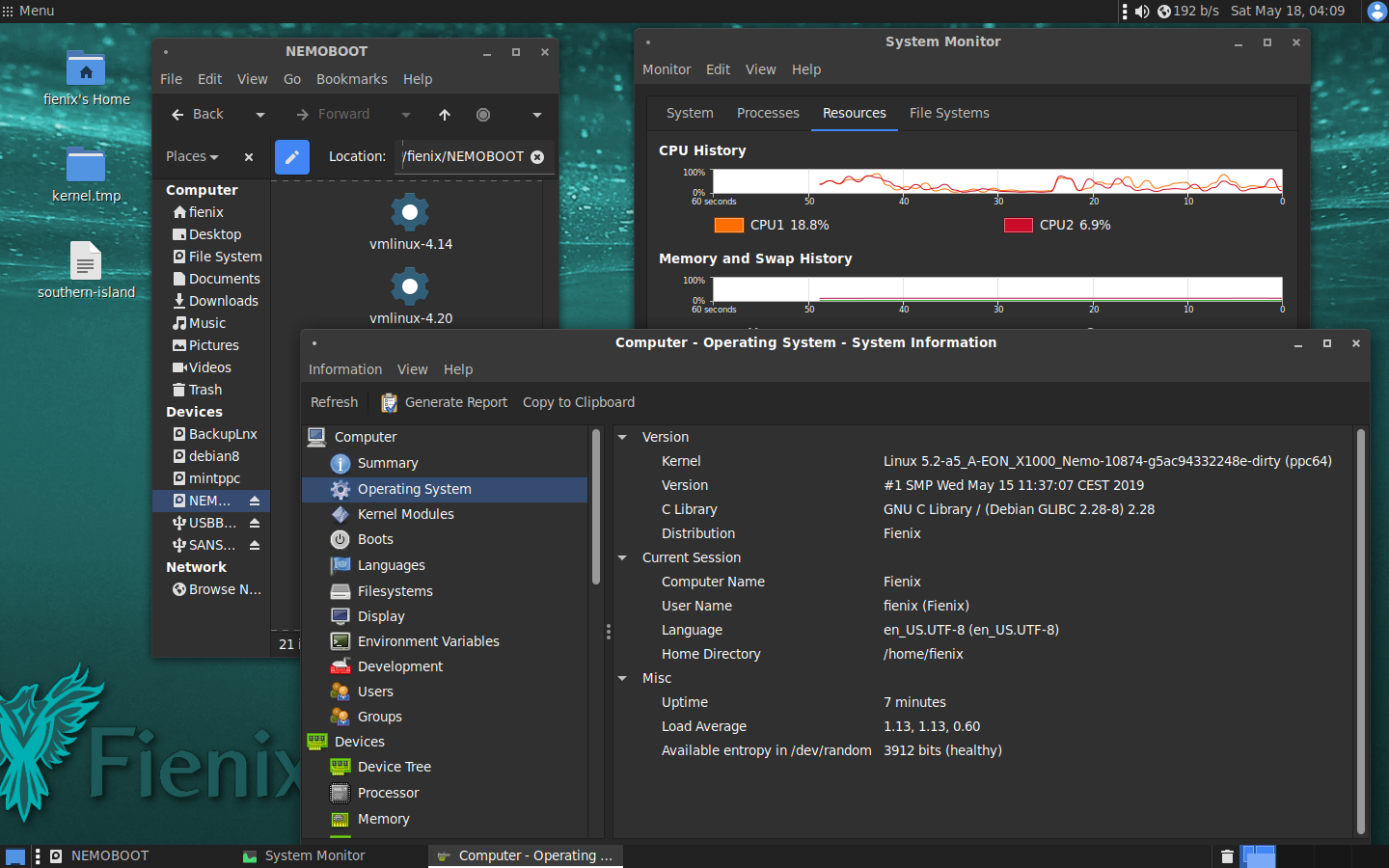

Here is the alpha5 of kernel 5.2 for testing. :-)
  • X5000: Additional test kernel (uImage-hid4) because of the issue with Logitech wireless USB mice
Download: linux-image-5.2-alpha5-X1000_X5000.tar.gz
Screenshot of openSUSE Tumbleweed PPC64 with Arctic Fox 27.9.17 and with the kernel 5.2-alpha5:
BTW, I created a new PowerPC cross compiling environment on ubuntu MATE 18.04.2 LTS x86_64 (GCC 7.4.0) three days ago. This kernel has been compiled with this new cross compiling environment.

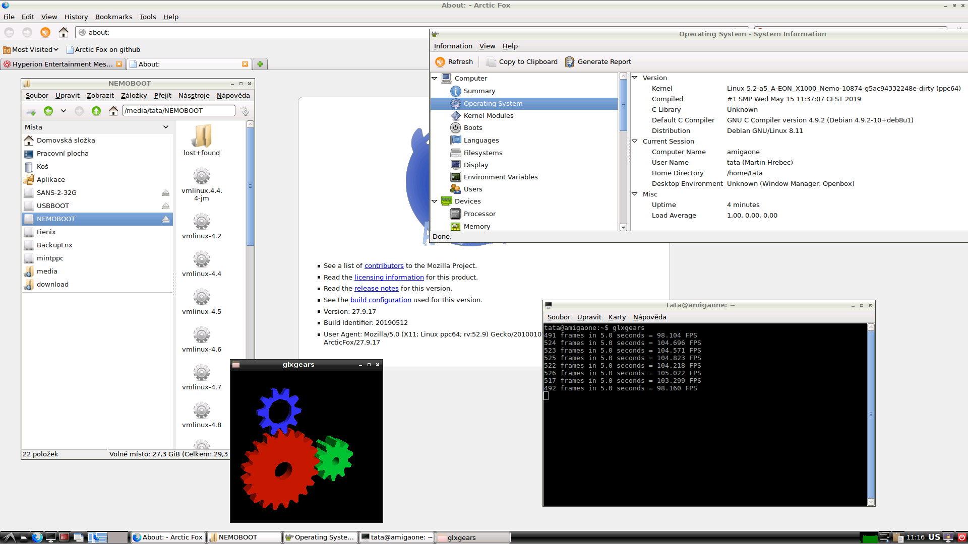

@SailorMH
@Ace
Please test the default kernel (uImage-5.2) with your two installed graphics cards and the additional test kernel (uImage-hid4) with your Logitech wireless USB mouse.

thanks to xeno74 and Darren, works with pcmcia patch

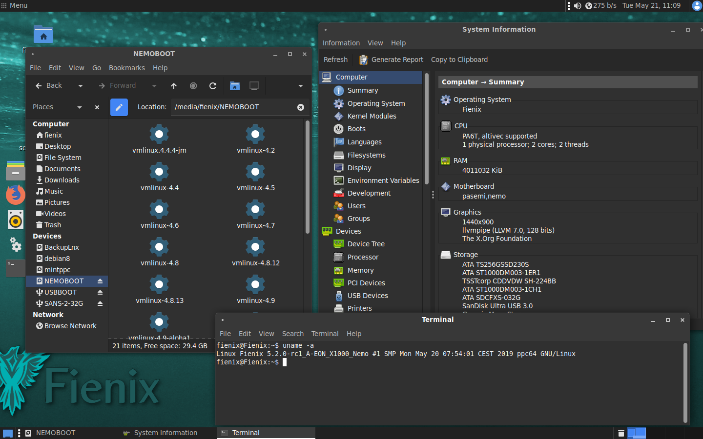

I released the RC1 of kernel 5.2 for testing today. :-)
  • X5000: Additional test kernel (uImage-hid5) because of the issue with Logitech wireless USB mice
  • X1000: Darren's pcmcia patch for solving the issues with new CF cards connected to the onboard CompactFlash Card Slot
  • X1000: Enabled the kernel config options CONFIG_PATA_PCMCIA, CONFIG_PCMCIA, and CONFIG_ELECTRA_CF for the pcmcia patch
Download: linux-image-5.2-rc1-X1000_X5000.tar.gz
Screenshot of ubuntu MATE 16.04.6 LTS PowerPC with Arctic Fox 27.9.17 and with the kernel 5.2-rc1:

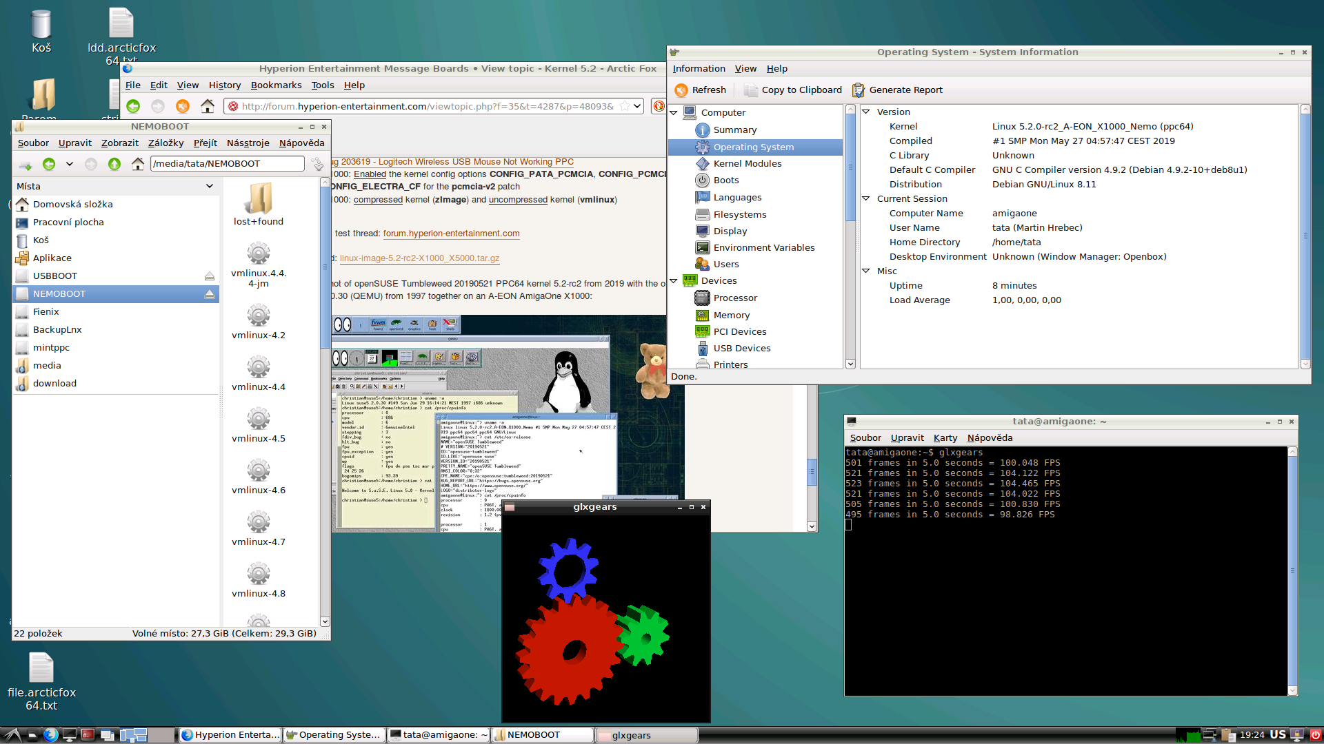

The RC2 of kernel 5.2 is available for testing. :-)
  • X5000 and X1000: vgaarb patch for solving the issue with two graphics cards in an AmigaOne. Bug report: Bug 109345 - drm-next-2018-12-14 -Linux PPC
  • X5000: Additional test kernel (uImage-hid6) because of the issue with Logitech wireless USB mice. Bug report: Bug 203619 - Logitech Wireless USB Mouse Not Working PPC
  • X1000: Enabled the kernel config options CONFIG_PATA_PCMCIA, CONFIG_PCMCIA, and CONFIG_ELECTRA_CF for the pcmcia-v2 patch
Download: linux-image-5.2-rc2-X1000_X5000.tar.gz
Screenshot of openSUSE Tumbleweed 20190521 PPC64 kernel 5.2-rc2 from 2019 with the old S.u.S.E. Linux 5.0 x86 kernel 2.0.30 (QEMU) from 1997 together on an A-EON AmigaOne X1000:
@SailorMH
@Allan (Ace)
I added an additional kernel for you to the package (uImage-hid6). You can use your two graphics cards and your Logitech mouse with this kernel. Many thanks for your help with testing and reporting the issues to the kernel developers! :-)

thanks, it works.
cfcard OK, tested Fienix and Debian8
