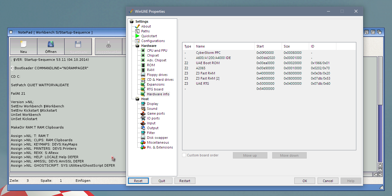

I set "C:Bootloader COMMANDLINE="NORAMPAGER" in startup-sequence and set WinUAE to add Z3 Ram (see image)...
I installed Upd. 1 and did reset myself, instead of letting the installer/system do it.. Well - no pink screen, system boots!
BUT - still no additional RAM

Can you make sure you are using INDIRECT UAEBoot rom? It's in one of the settings there. Also just try one smaller block (maybe 128MB) of Zorro III ram to start.
