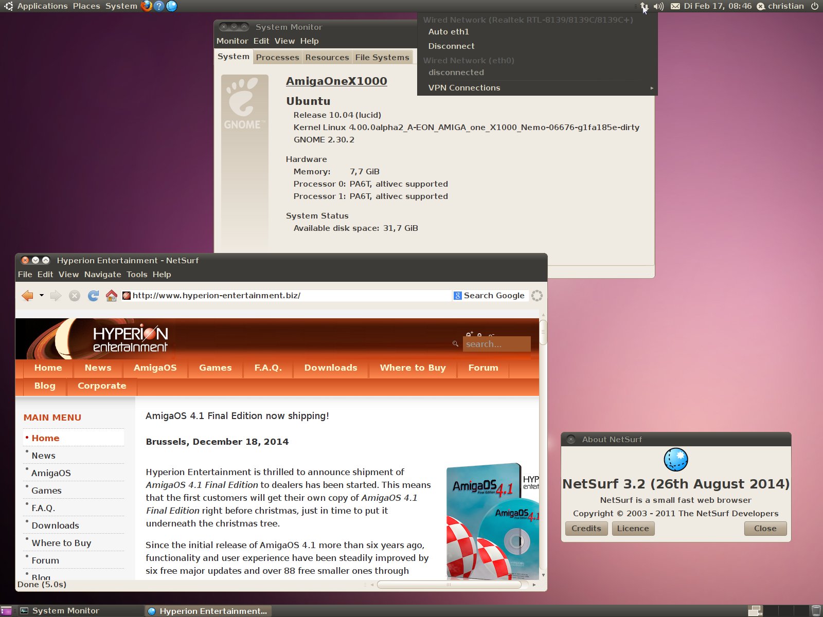

Not really. Kernel 4.00 alpha works well with Lubuntu 12.04.5 LTS and Ubuntu 10.04.4 LTS:

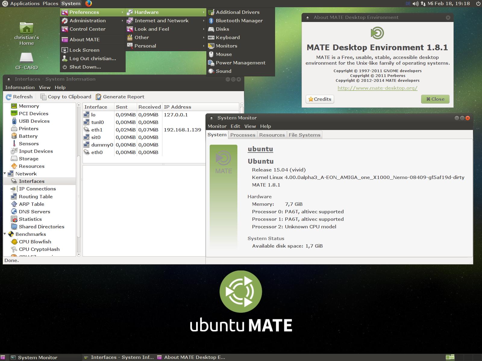

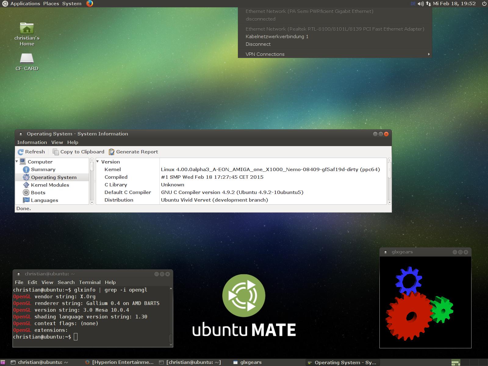

Re: Kernel 4.00 (3.20)
I have good news. The alpha3 works with ubuntu MATE 15.04. It hasn't problems with the network devices.
Here is the download of the alpha3: vmlinux-4.00.0-alpha3-AMIGA_one_X1000.tar.bz2
