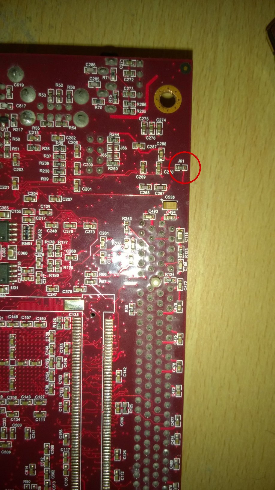

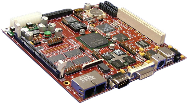

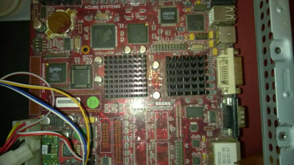

Also, in addition, I am very concerned that I may have a prototype board or something, if you compare the first picture top, to the one on the Acube Site, my one has chips missing on the circuit board!

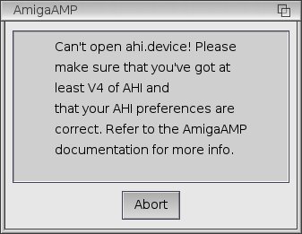

What AmigaAMP says when I try to run it (Lower image)

@Mikey_C
Try to use for MUSIC UNIT 'Unit 0: HiFi 16 bit stereo++' and then for Units 0, 1, 2, 3, the 'CS4281...' modes. Reboot system and see if it solves your audio problem.

I wouldn't be too worried that your board looks different from their picture. After all, their picture was almost certainly of a development or prototype board.
The missing "J61", though, is possibly significant. If that's what you are referring to with "chips missing", let me reassure you that it is not a "chip" but a link, usually made of a zero-ohm resistor. It could just as easily be a blob of solder. There is nothing missing from the "big" picture (it's the same on my board, they are just non-fitted connectors).
You could get someone at ANT who is handy with a soldering iron, to join the two pads with a blob of solder. Unfortunately, I can't see the underside of my Sam board to verify your observation. I'll dismantle it sometime today to take a butcher's at it.
If you have a serial terminal connected to the serial port, AHI will say something like "No CS4281 found!" during boot, if the sound chip is disabled. That would be a confirmation that there is a hardware issue, and you could then try the link.
ACube is really good at fixing this kind of issue, though. I would really suggest that you send them the picture of the missing link and ask them for advice, before taking any action with a soldering iron.

Yes, that J61 link is fitted on my board. Again, I suggest you contact ACube first, with the serial number of the board.

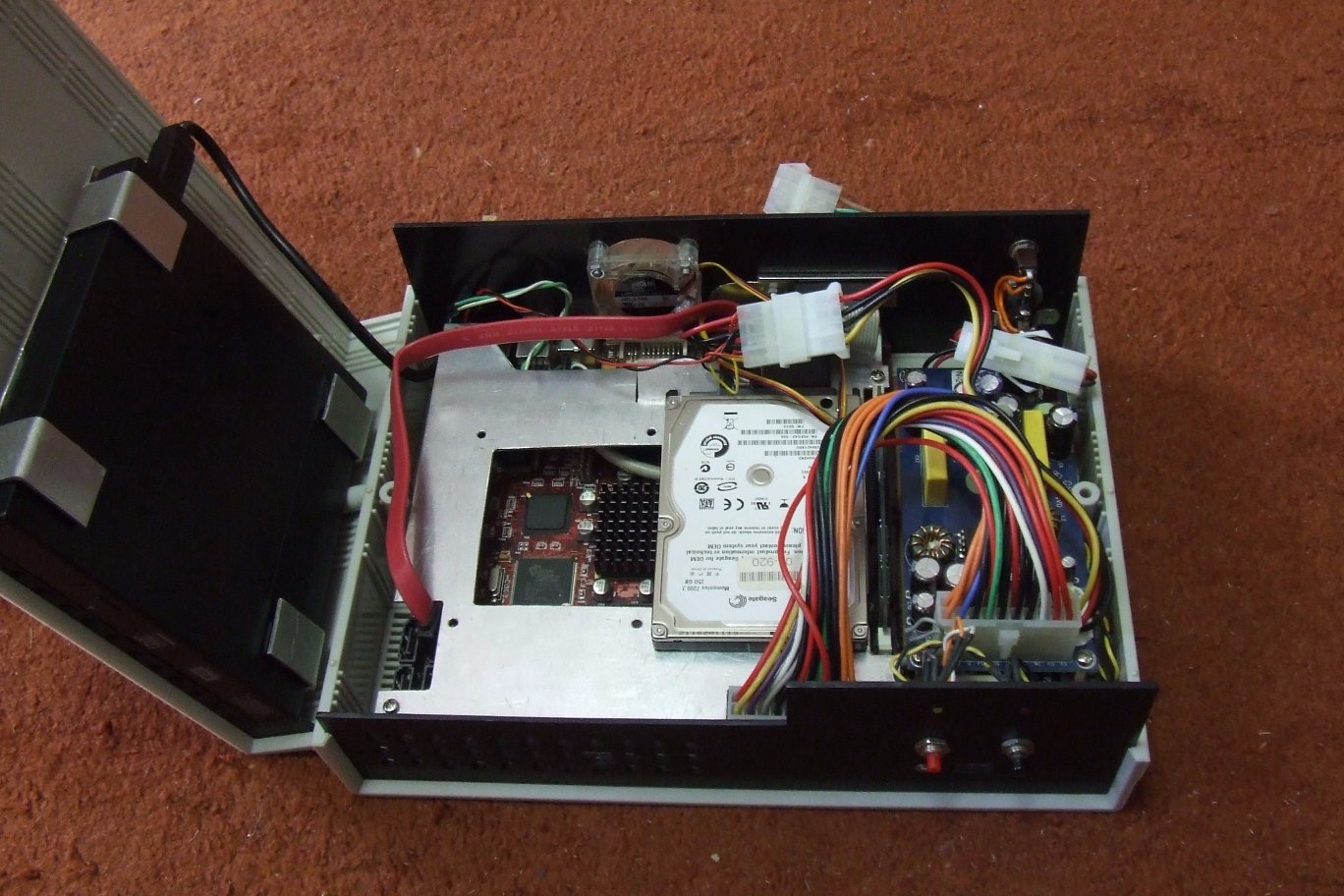

Just for fun, here is a picture-thingy of little Samantha, in her box. You can see the DC-DC PSU on the right (she takes 20-30 V DC input). The Molex connector at the rear feeds the TFT monitor with +16V and +5V supplies. She can run from a 24V mains adaptor or direct from 24V in the campervan.
There is a 250 GB 2½" HD mounted on the aluminium plate over the CPU board, with space for a second HD, USB CD/DVD in the roof of the box.

Hi Guys, Thanks for all your help so far, I am okay with a soldering iron, I could have a crack at it myself, but really, I am not sure what the problem is exactly, I posted the J61 pics because In dialogue with ACUBE they asked me to check if the Jumper at J61 was present, as you can see, it is. However I have sent them an email regarding the jumper (with photo), about 2-3 weeks ago I think, still haven't heard anything back. Sent another email again last night, waiting to hear back.
