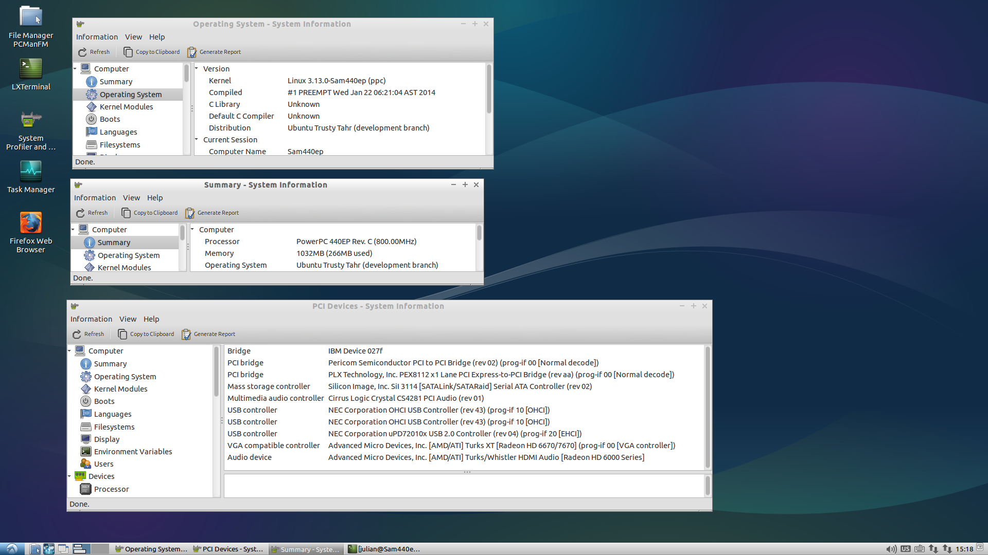

Re: Lubuntu 14.04
Sam440ep , Lubuntu 14.04 and Kernel 3.13.0
Keeping up with the Jones's .
(392.1 KiB) Downloaded 235 times

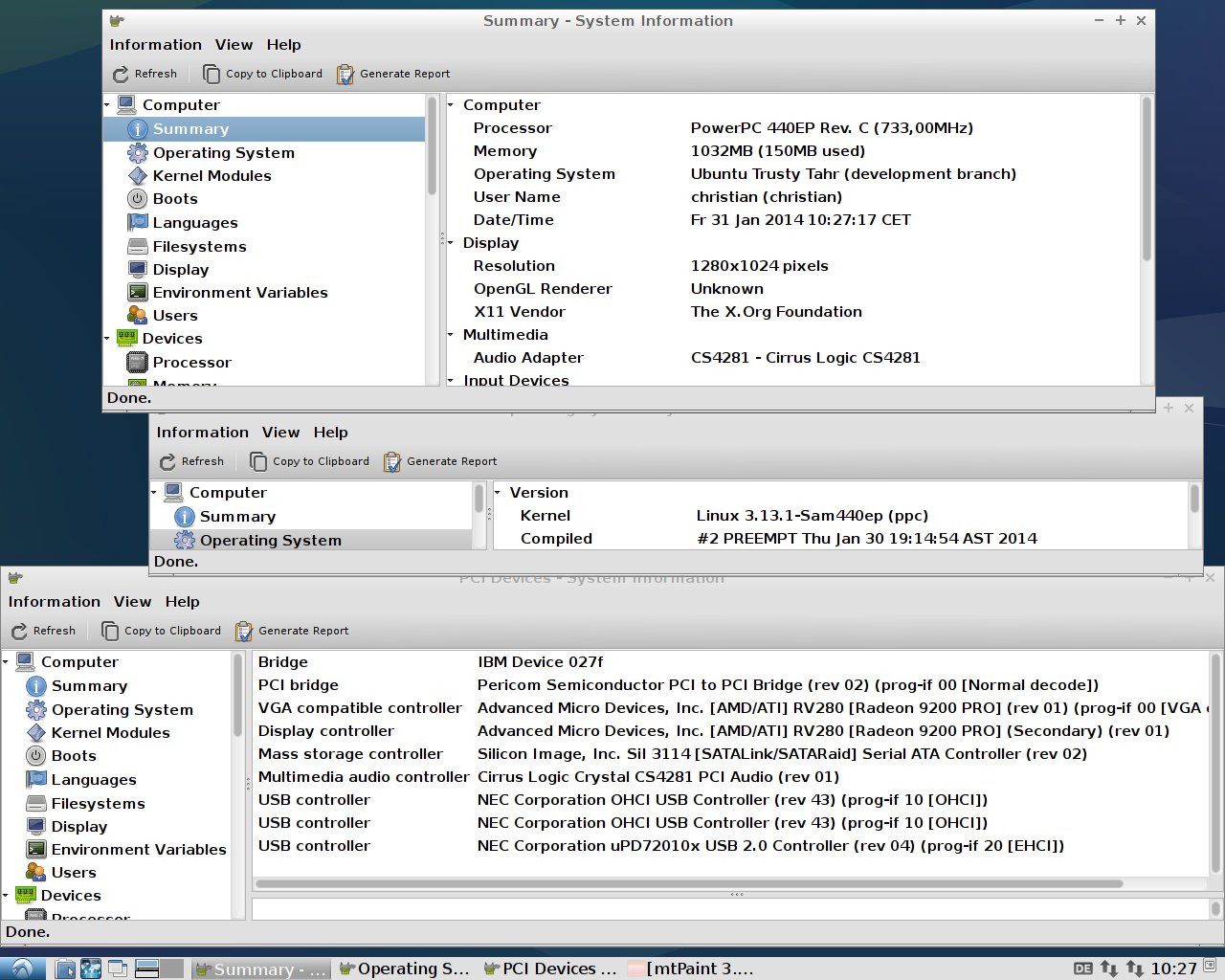

Hi Spectre660,
I've installed Lubuntu 14.04 on my Sam440ep Flex rev 2 (733 MHz, ATi Radeon 9250 PCI 128 MB VRAM). It works very well with kernel 3.12.5. But with kernel 3.13.0 and radeon.dpm=0, Xorg works with the framebuffer driver and with only 8 colors.
(235.52 KiB) Downloaded 211 times
Thanks a lot for your work! :-)

Re: Lubuntu 14.04
Spectre660 wrote:@xeno74
Thank you.
Your feedback is just what I need as I don't have a working Radeon 9250 card.
Can you try this new 3.13.1 kernel please.
I have removed the Radeon Framebuffer as was the case with kernel 3.12.5 .
https://dl.dropboxusercontent.com/u/542 ... 3.1.tar.gz
Thanks a lot! Your kernel 3.13.1 works very well. :-)
(260.64 KiB) Downloaded 182 times
Edit: I've uploaded your new kernel: Sam440ep-3.13.1.tar.gz
Thank you very much for your work. :-)

Posts: 1538
Re: Lubuntu 14.04
Second Version of Kernel 3.13.1.
Added back some elements in Bus configuration and scrolling seems faster to me with my Radeon HD 6670.
https://dl.dropboxusercontent.com/u/542 ... 1-2.tar.gz
