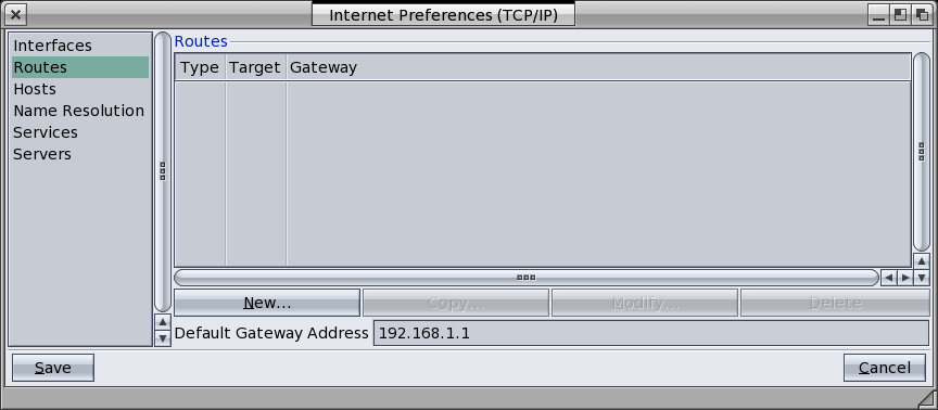

Sounds like your router address may be wrong.
You need to verify your router address.
You may have to look at your routers documentation to find out how.
Then use that address as the default gateway setting using Prefs/Internet .
After starting the Internet prefs tool select Routes and then type in the address of your router at the bottom where is says Default Gateway Address.
Then Click save.

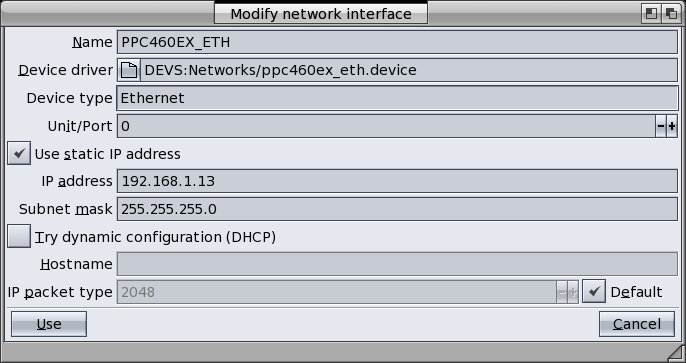

When I go to Prefs/Internet and the Internet Preferences (TCP/IP) window opens, under Interfaces (or whne highlighted) I have my netowrk connection "PPC460EX_ETH". Clicking on "Modify" brings up the Modify network interface windows with the following options or lines:
Name PPC460EX_ETH
Device driver DEVS:Networks/ppc460ex_eth.device
Device type Ethernet
Unit/Port 0
Use static IP address (blank)
IP address Blank
Subnet mask Blank
Try dynamic configuration (DHCP) Checked
Host name Blank
IP packet type Gosthed or greyed out 2048
Default Checked.
Use or Cancel
I don't see anywhere to enter gateway values.

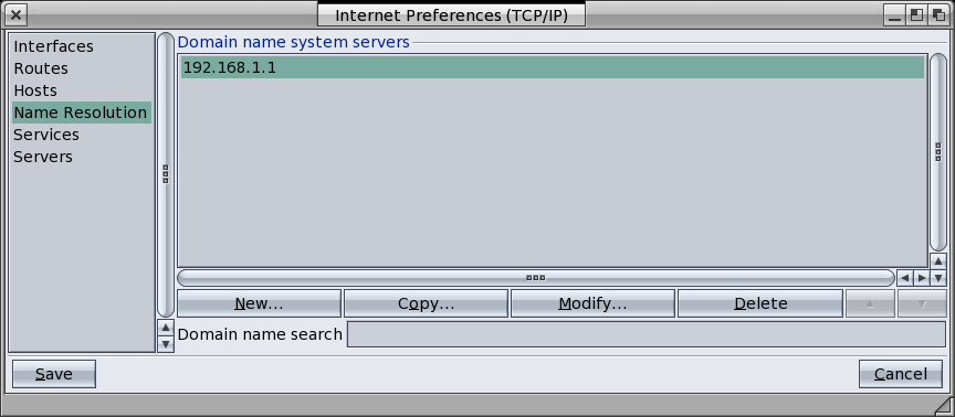

Posts: 1538
Re: Unable to access network connection in SAM460ex with OS4
This is how mine looks.
You actual type it in to the same box that show the Default gateway address
(26.31 KiB) Downloaded 177 times
