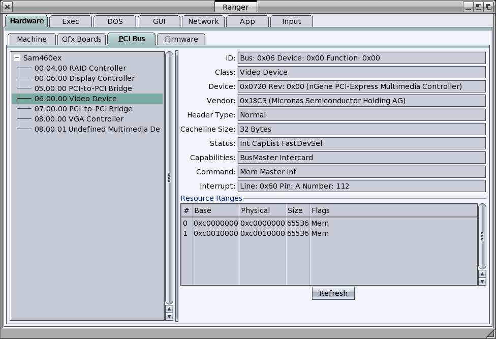

Ranger Grab of PCIEx1 Device
Ranger Grab of PCIe x1 Device
(119.3 KiB) Downloaded 2058 times

Ranger Grab of PEX 8112 pciex1 tp pci adapter bridge card on Sam460ex.
Only the Bridge shows up in Ranger. The pci sii3112 sata card attached to the adapter bridge card does not show up.
Edit: This bridge card seems to be defective. Will try angain when I get a replacement

Received my new PEX 8112 pciex1 to pci adapter bridge card today.
A Sound Blaster Live! plugged into the bridge card shows up in Ranger and is recognized by AHI prefs.

Screengrab of Ranger showing Soundblaster Live! attached to the PCI-E to PCI Bridge.
(77.79 KiB) Downloaded 1612 times
