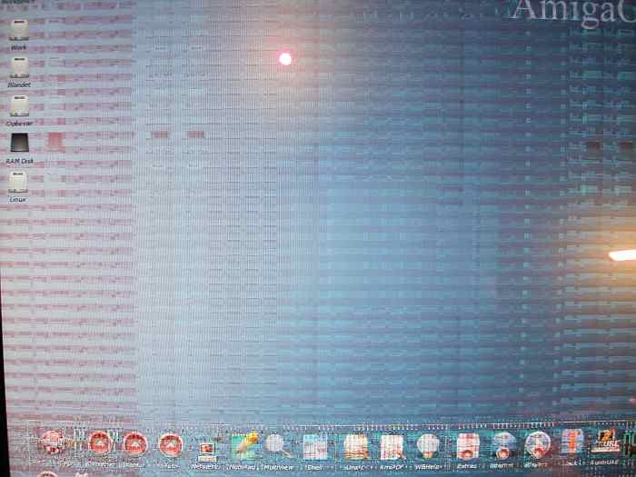

Re: StarTech PCI express to PCI adapter works in my X1000
Hi
After replacing my PCI Express PCI adapter with a new one, I got it to work. Network card started up in the fly and a ping showed that there was a hole through my network to my router.
So I began to follow the setup wizard for 2 graphics cards. Everything went fine apart from that my radeon 9250 does corrupt graphics.
Is there someone there has an idea of ​​what could be wrong? See attached photo.
I certainly not have luck with this project :)

musa wrote:Hi
musa,
Sorry to hear your troubles. As I stated in my earlier post, these cards are notorious for incompatibilties with many (PC) motherboards. Interesting that your first one didn't work but the second one did. I have 2 of these StarTech cards and they both worked the same for me in the slots that I tried. To give you the exact model network card I used in the PCIe slot 1 removed from the PCI slots, it is a TP-LINK TG-3239DL PCI (Realtek RTL8139D) which I picked up brand new for only $10 and the build quality looks quite good. I am not aware if these PCIe-PCI adapters are all created identical (I would have thought so), or whether it is our different PCI network cards, or the different configurations/cards of our X1000s.
I do not have a Radeon 9250 in my X1000 config to test, but my catweasel and sound card in the 2 PCI slots both worked fine in OS4 with no problems I could find. Hopefully someone with a config more similar to yours can suggest.
I hope you can confirm whether the Radeon 9250 works perfectly if the adapter with network card is not installed in the machine - if this is the case, then the adapter is doing something resulting in a problem with the Radeon card.
