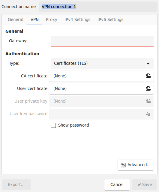

Thanks! I was able to install both of them, and the respective plugins for Network Connections prefs. But there is now one problem... The 'network-manger-openvpn-g' (Gnome) is needed also! Without it, OpenVPN prefs lack the most important tab ("VPN"), and without it you cannot configure the connection (User, Password, Gateway and certificates are defined there)! So, would it be possible to add also that to the deposit...?
I checked this with an Ubuntu18 distro, which originally had that 'VPN' tab in OpenVPN prefs. When I removed the 'network-manger-openvpn-g' installation, the 'VPN' tab also disappeared!

Please try to install network-manager-openvpn-gnome. Does that take care of it? Or do you also need to install network-manager-gnome (also added). Let me know; perhaps I'll create a metapackage so it's easier for everyone to install everything they need.
UPDATE: I installed network-manager-gnome and network-manager-openvpn-gnome to get an "Advanced Networking Configuration" option in my control center. This appears to be what you were referring to. Please confirm.

I had already network-manager-gnome installed. I now installed "network-manager-openvpn-gnome" (was it in the depot already yesterday? How did I not notice it...), and it did the job. Thanks!!-)
I was referring to the next step, when you are configuring the created OpenVPN connection. You can see the 'VPN' tab there after installing "network-manager-openvpn-gnome":
