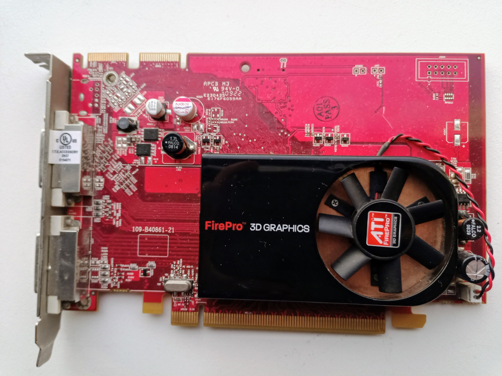

I am trying to get dual graphics cards running in Fienix. Excuse me in advance if the questions has been answered before and my problem is noobish :D
I am running the 5.1.14 kernel but I can not seem to get 3d going on the FirePro 2250 that I have installed besides my R9270x.
I have installed the FirePro 2250 in the buttom PCIE1 slot and it shows up fine when I type lspci:

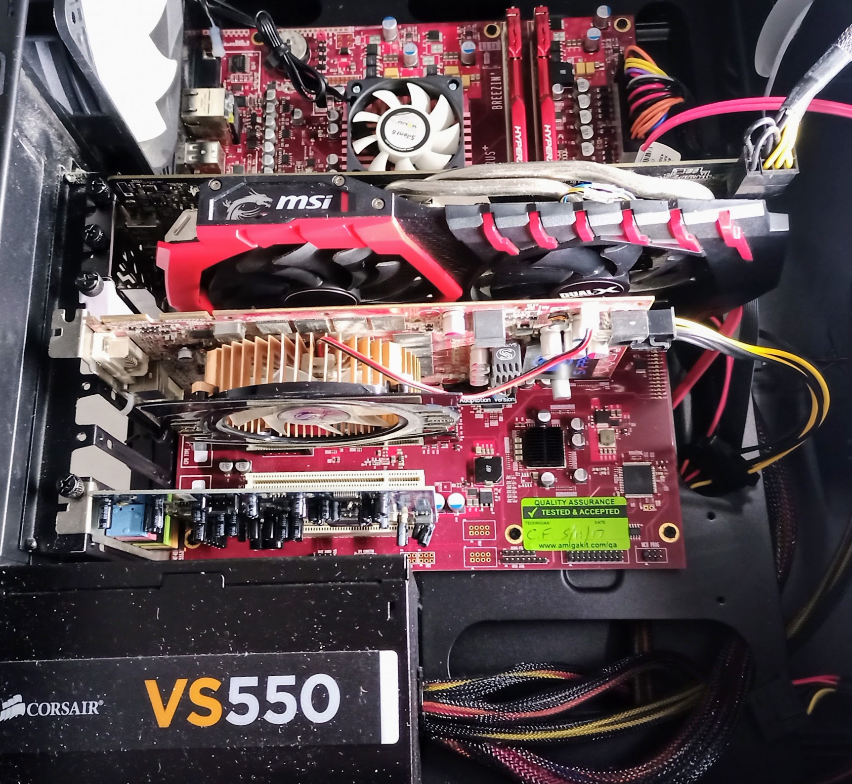

My cards are:
PCIx16=Radeon R9 270x
PCIx4=Empty
PCIx1:ENVy24PT soundcard
PCIx1FIrePro2250
PCI=Ethernet (used on linux)
PCI=SII3114
I can boot fine in both Fienix and OS4,1 with this configuration.

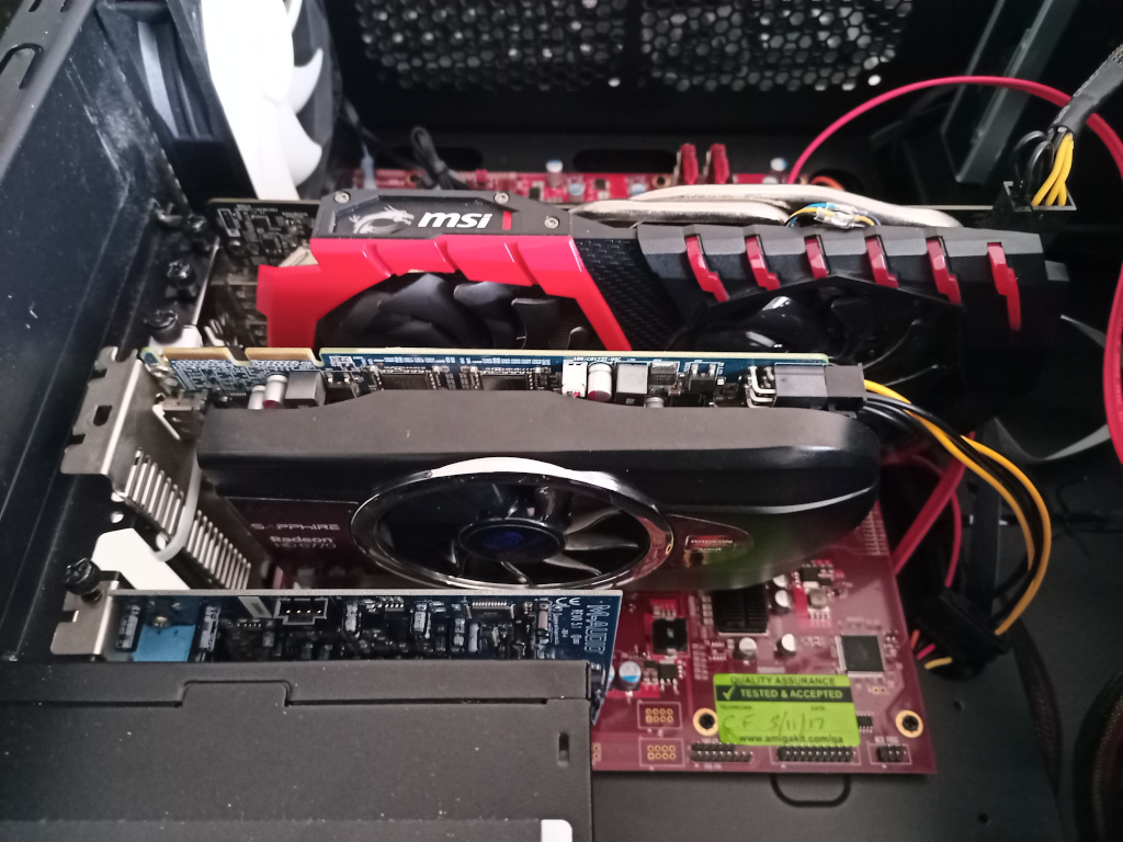

gerograph
Posts: 97
Joined: Sun Mar 25, 2012 10:24 am
Location: Moers
Re: Dual graphics cards - a couple of noob questions :-)
Post by gerograph »
I thought I post here as well:
Radeon HD 4650 in the second PCI Slot (counted from top) - this is planned for Linux
Radeon HIS in the firs PCI Slot (counted from top), this is where CFE is displayed (if plugged in) - planned for AmigaOS
When booting with old Debian Wheezy from USB Pendrive (see A-Eon Downloadsection and Trevor's install guide there), Radeon 4650 will be chosen and used out of the box. BUT when booting with Void Linux (see viewtopic.php?f=35&t=4714&start=20) I will get a black screen. It only works, when only one Graphic Card is hardwarewise mounted. Creating (!) an xorg.conf on Void didn't solve the problem, therefore I just copied some files over from debian Wheezy:
gerograph wrote: Tue Nov 23, 2021 12:38 pm I did it :-)...this is what I did:
  • mounted both Graphic Cards
  • booted the old Debian from USB (X1000 A-Eon Downloadsection), which brought me right into XFCE on my Radeon 4650
  • saved the file etc/X11/xorg.conf.d/10-vsync.conf
  • unmounted Graphic Card Radeon HIS
  • booted Void from HD
  • created a directory xorg.conf.d in /etc/X11
  • copied 10-vsync.conf into there
  • also copied 10-vsync.conf into usr/share/X11/xorg.conf.d
  • mounted 2nd Graphic Card again, and after reboot, everything worked like supposed
I am not 100% sure wether I need 10-vsync.conf in both locations ?
Do I still need 10-radeon.conf in usr/share/X11/xorg.conf.d ?

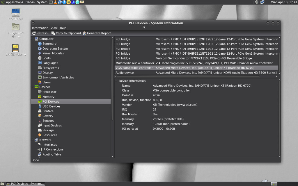

Posts: 981
This i how i got a second graphics card up and running in my AmigaOne X5000. (click on the link below)
https://www.skateman.nl/index.php/2022/ ... -graphics/
Most issues i had was with getting a working xorg.conf. So here is mine based on the Driver "radeon"

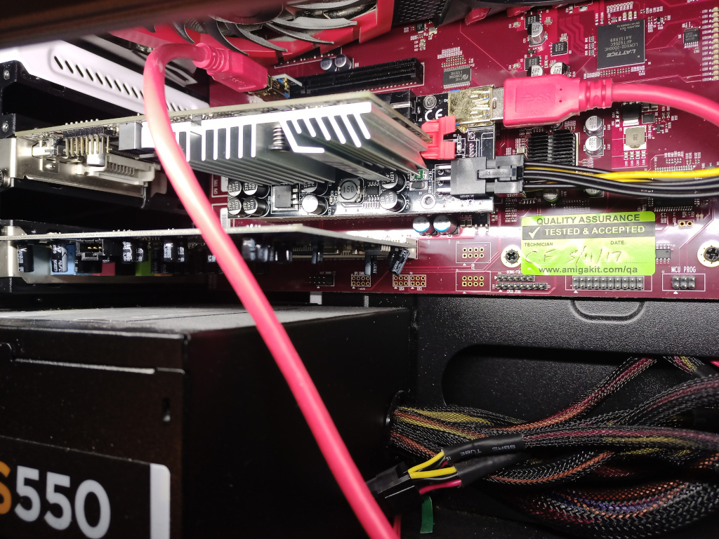

Posts: 981
UPDATE!

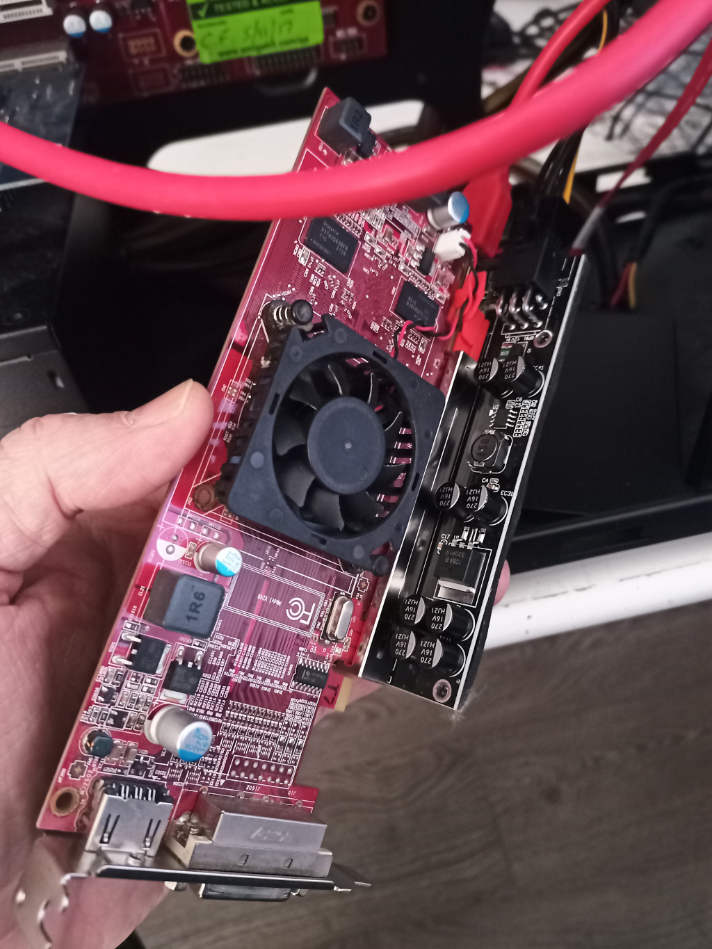

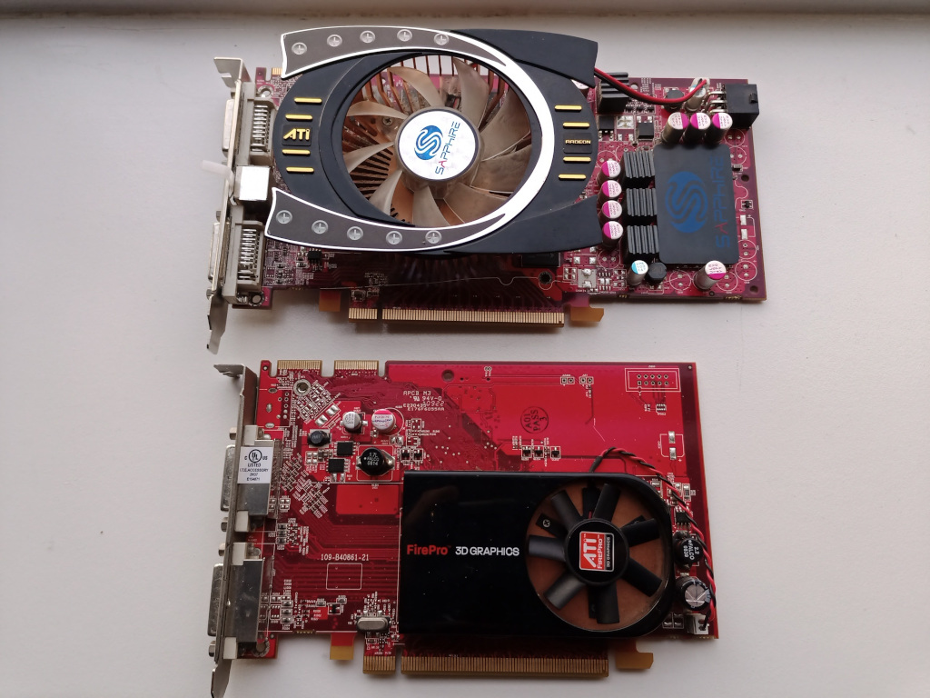

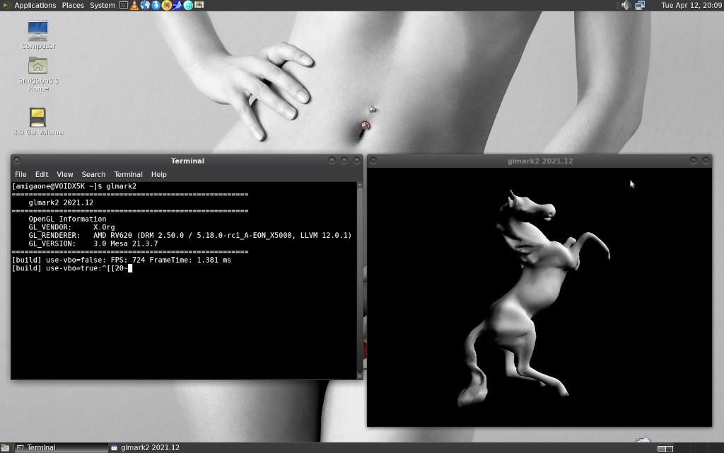

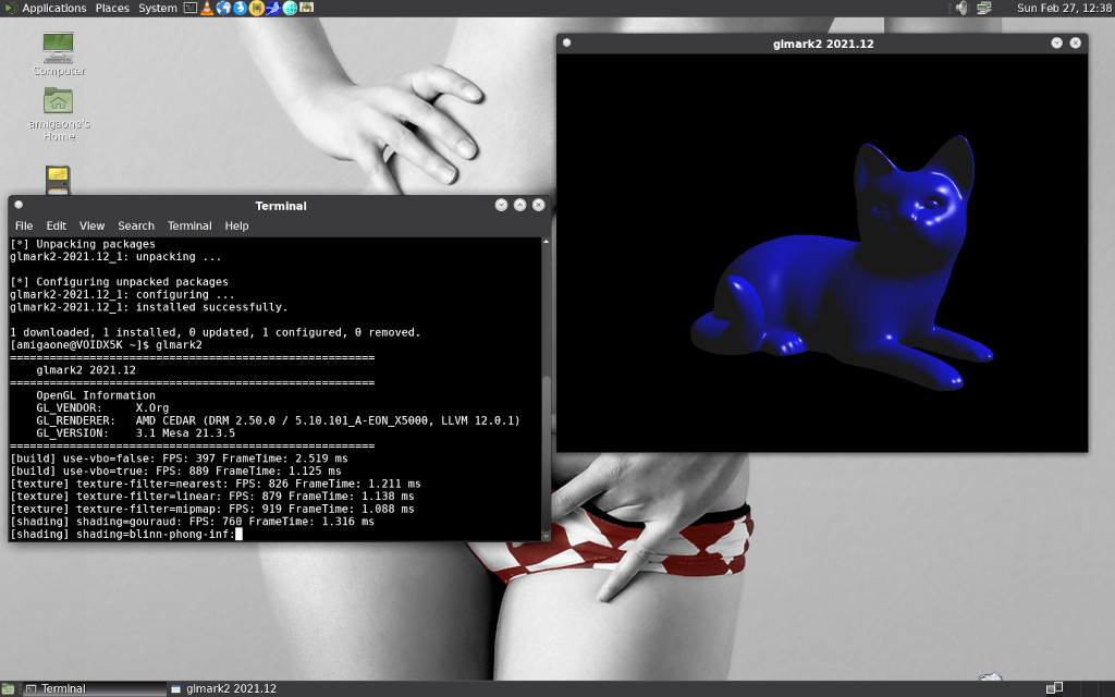

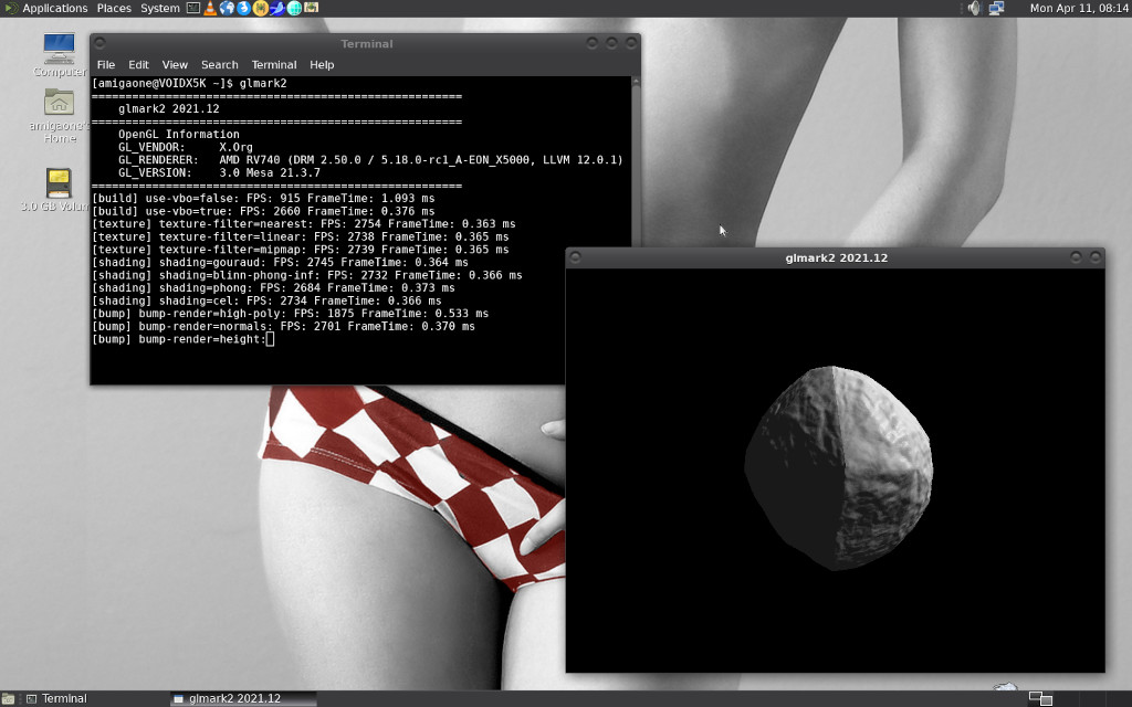

The second graphics card has been upgraded. The Radeon 5450 is repaced for a Radeon 7450.

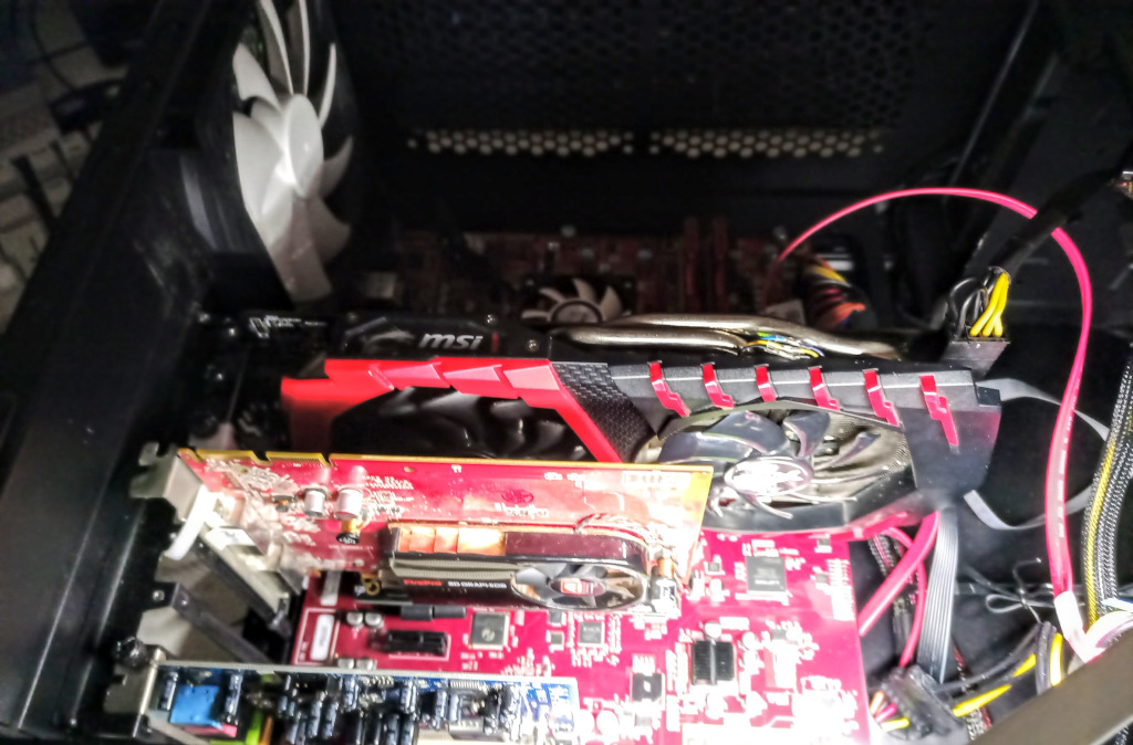

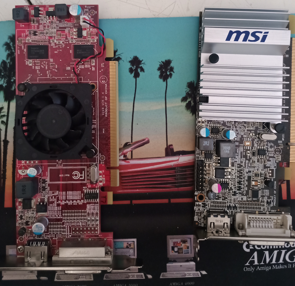

Old and New!

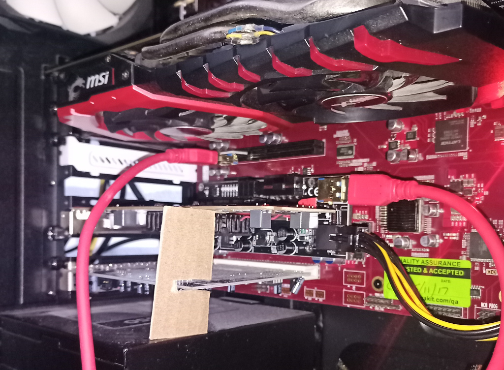

7450 in PCIe riser
Quick and dirty Low Profile fix... (but works)
Inside view..(with a cardboard support bracket)

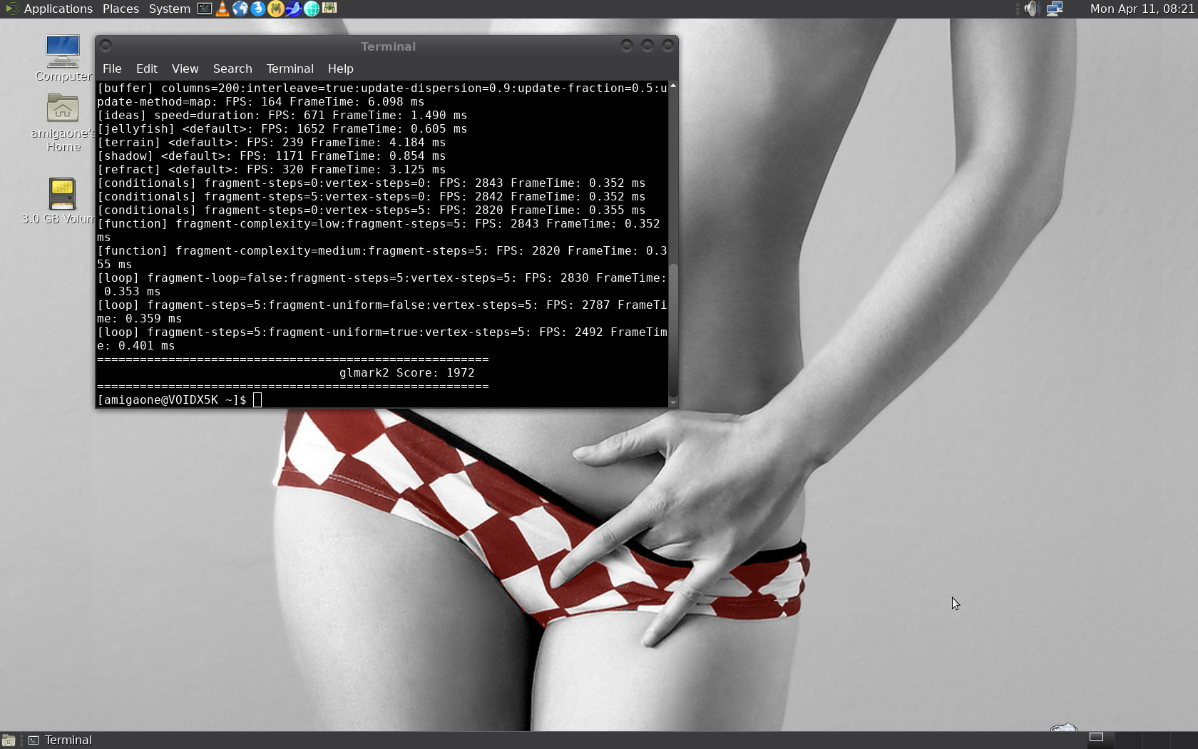

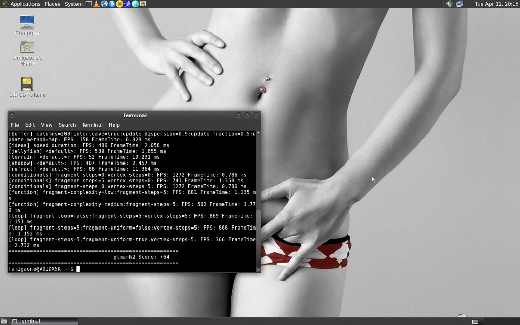

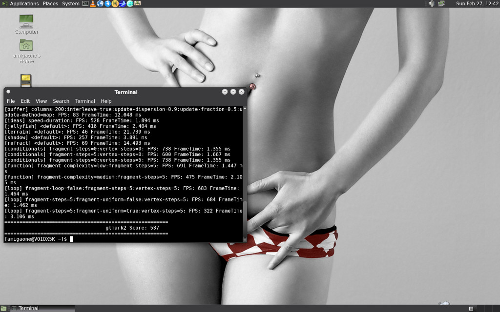

GLmark2 based on the 5450
GLmark2 Score of 537 based on 5450

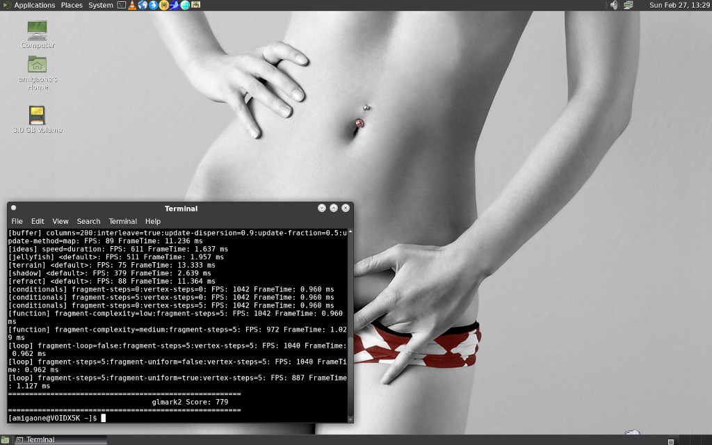

GLmark2 based on the 7450
GLmark2 Score of 779 based on 7450
