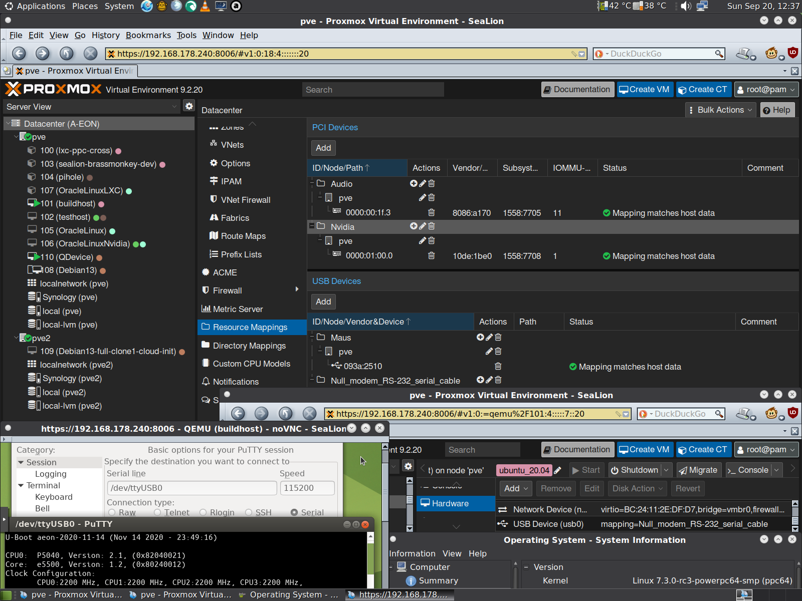

It is possible to connect U-Boot and a shell from the X5000 via a null modem RS-232 serial cable. I use a USB null modem RS-232 serial cable.
Screenshot:
Posts: 11506
Re: X5000 via null modem RS-232 serial cable
You can get a complete serial log with PuTTY:

Posts: 11506
It also works with PROXMOX Resource Mappings:
