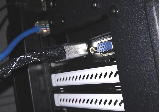

What type of connection (cable, plugs) do you use between the card and the monitor?
Which monitor do you use?

I have a Samsung 4K monitor.. to be honest, I'm not 100% of the model but it's a dual input so I use 4K for my Windows box.
I'm using a DVI -> HDMI adapter from the Amiga to the monitor. And now that I said that, maybe that's the issue?

icbrkr wrote:I'm using a DVI -> HDMI adapter from the Amiga to the monitor. And now that I said that, maybe that's the issue?
Does the DVI plug support full DVI Dual Layer (DVI DL)? I.e. does it have all the pins in one rectangular block or is there a sort of gap in the middle, creating two squarish blocks of pins? If the latter, you need a better adapter with the full DVI DL.

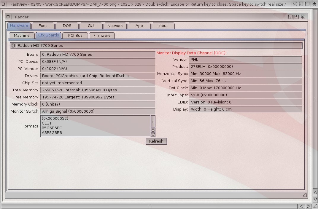

Yes, but does the X5000 gfx drivers allready supports the HDMI port of the 7700 ?
Posts: 968
Re: 4K?
Yes it does :-) Works out of the box with my X5000 and Radeon R7 250 (7700 series)
Raziel
Re: 4K?
Post by Raziel »
Skateman wrote:Yes it does :-) Works out of the box with my X5000 and Radeon R7 250 (7700 series)
Then you must have a newer/beta gfx driver
I have a 7750 in my X1000 and i only get mush when i plug the HDMI cable into the card.
It's not the monitor, and it's not the cable and it's not the card.
I tested all of them in a PC, same cable, same monitor, same card, works perfectly there...but i couldn't even get 2560x1440 out of it on the Amiga side.
Posts: 968
Re: 4K?
i am running a 30inch Philips in FULL HD on my X5000. So that not 4K, but the HDMI part does work
