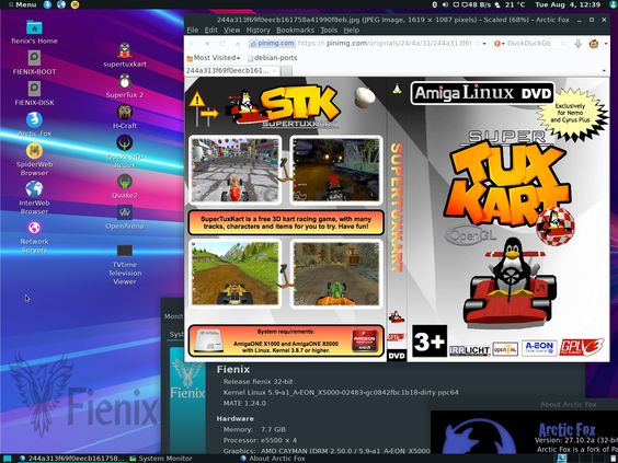

I compiled the alpha2 (latest Git kernel) today.
Unfortunately, Xorg doesn't start on some Linux distributions anymore. For example on Fienix (Debian Sid PowerPC 32-bit) and on ubuntu MATE 16.04.6 (PowerPC 32-bit). I tested these distributions on the X1000, X5000, and in a virtual e5500 QEMU machine with a virtio_gpu.
Error messages:
systemd-journald[2238]: Failed to send WATCHDOG-1 notification message: Connection refused
systemd-journald[2238]: Failed to send WATCHDOG-1 notification message: Transport endpoint is not connected
But Xorg works on Ubuntu 10.04.4 (PowerPC 32-bit), openSUSE Tumbleweed 20190722 PPC64 and on Fedora 27 PPC64 with the alpha2 (latest Git kernel).
