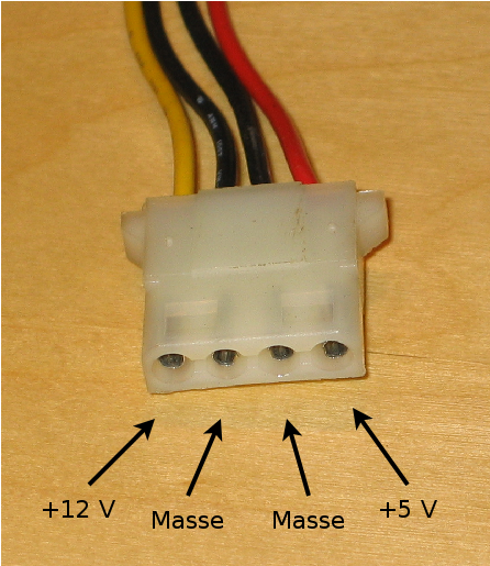

You can switch 12v to 5v and the fan have enough power for cooling, is much quieter. I did it with all my fans

tommysammy wrote:You can switch 12v to 5v and the fan have enough power for cooling, is much quieter. I did it with all my fans
How excatly do you do that? :-)
You have to switch the yellow and red cable. Note: you do it at your own risk

One possible problem with running fans on 5 volts, if you ever run the CPU/GPU hard enough, the slower fan may not be able to keep things cool enough. If you want "smarter" tools, consider a fan speed controller with temperature sensors.
You won't get the actual CPU core temp, but a sensor stuck to the side of the CPU heat sink could control the CPU fan speed, another sensor stuck on to the GPU heat sink could provide variable fan control there too.
Here's one example.. http://www.newegg.com/Product/Product.a ... 3XT1R66877
NOTE: I have never used this exact model, but I have used similar devices in the past.
This way you get the quiet of slow fans when you're taking it easy, but the fans will spin up as you drive the machine harder.
