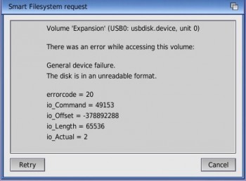

Now I am trying to back up this same hard drive to an external USB drive. I can only copy a few gig at a time before I get the same error:
I plugged the USB drive into a Sam 460, and the same result: it would copy only so much and then throw up the same error. I have tried creating JXFS, SFS. SFS/02 and got a similar error or sometimes just a lock-up. The most I've got through is 11 GB, but sometimes I've had the error with as little as 800 MB.

from that screenshot, ive had that type of error before(lots of them) I started getting them when I bought some 1gb Infineon ram modules which turned out to be not suitable. Those SFS error windows popped up all the time, along with system crashes.
Have you ruled out the possibility of it being faulty ram(memtester/uboot mem test and /or swapping with some other ram etc)
If there was something wrong with AmigaOS drivers you would probably notice the same error with the same values(boundry errors or bit precision etc) but I bet you get different block numbers in the error. It more likely the SFS diskcache contents getting corrupted or internal filesystem buffers.
