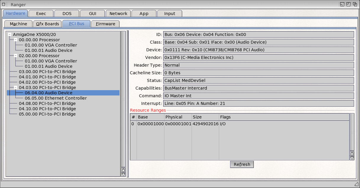

Re: New x5000 owner, some issues
This is exactly the issue that I'm having too. Sound actually works quite well with fresh install, but after Enhancer package it started to behave strangly. I sometime manage to get it back when playing with mixer-utility. My competer is not crashing but sound just disappers, when I have time I'll check whether the old sound prefs (AmigaOS install disk) will work better.icbrkr wrote: Playing sound with TuneNet would cause it to lose sound after about 20 seconds and it would reappear only when you hard-rebooted. Plaiyng videos via YouTube was impossible as it would lock up. When I moved to the upper PCI slot, it started working better and has only crashed a couple of times.

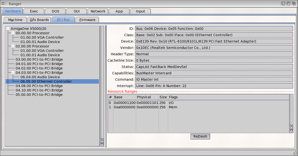

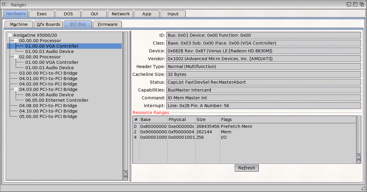

Reverted to a more standard configuration .
8139 Ethernet card in the last pci slot and CMI8738 audio card in the first pci slot .Video card ASUS Radeon R7 250 (Verde chipset)
Have not had any sound problems during video playback or with Tunenet under AmigaOS 4.1 and with the Enhancer Plus Package installed .
Both of the PCI cards mentioned above are old. Have had them for a long time .
I finally had time to check the sound issue:
- I switch back my old Fortemedia PCI card from A4k
- with new Enhancer pack and sound prefs there the sound just freezes e.g. when using streaming (youtube, nectarine etc.)
- copied the original ahi prefs application from OS4.1 FE pre installation -> sound works as expected whole evening
So for me at least this seems new sound prefs issue, yesterday I managed to play whole evening with Nectarine and playing around with installing some new software (e.g. the great AOrganiser).
[edit: my newer card is CMI based and graphics card is R9 280x]
I have PCIe NIC in this thing - I do have a 8139 in my 4000T. Guess I'll pull it out and see if it helps on the x5000.Spectre660 wrote:Reverted to a more standard configuration .
@ icbrkr
The pciex1 network card should not cause any problems .
The CMI sound cards are the culprit.
You could try to get a pci sound blaster Live!
https://www.amazon.com/Creative-Labs-So ... r+live+%21
