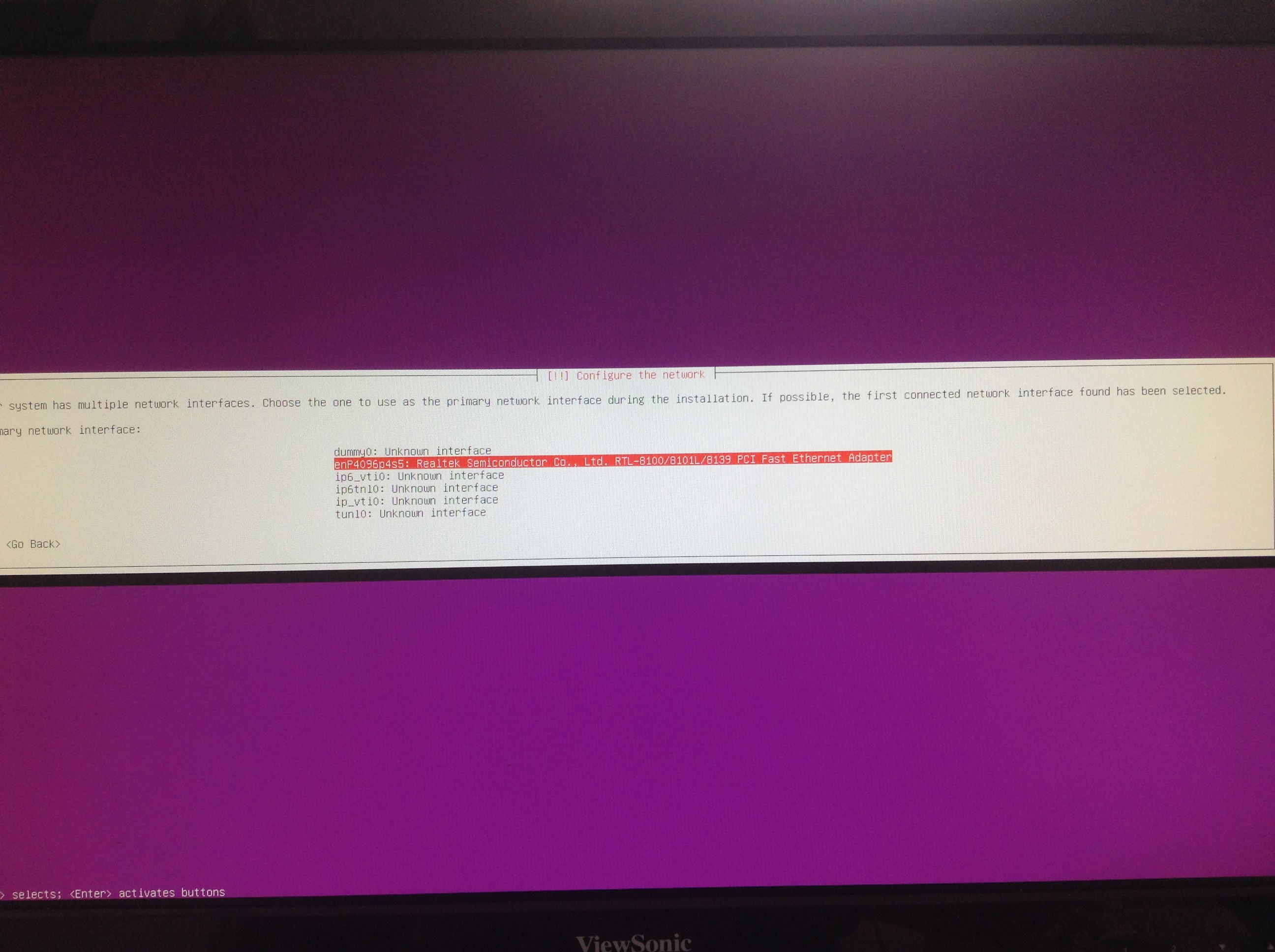

This is what I get when I run the installer.
This is a PCI 8139 ethernet card in the last PCI slot of my X5000 .
See the Right side of image # 1 for the System Information info
8139 Network Controller
