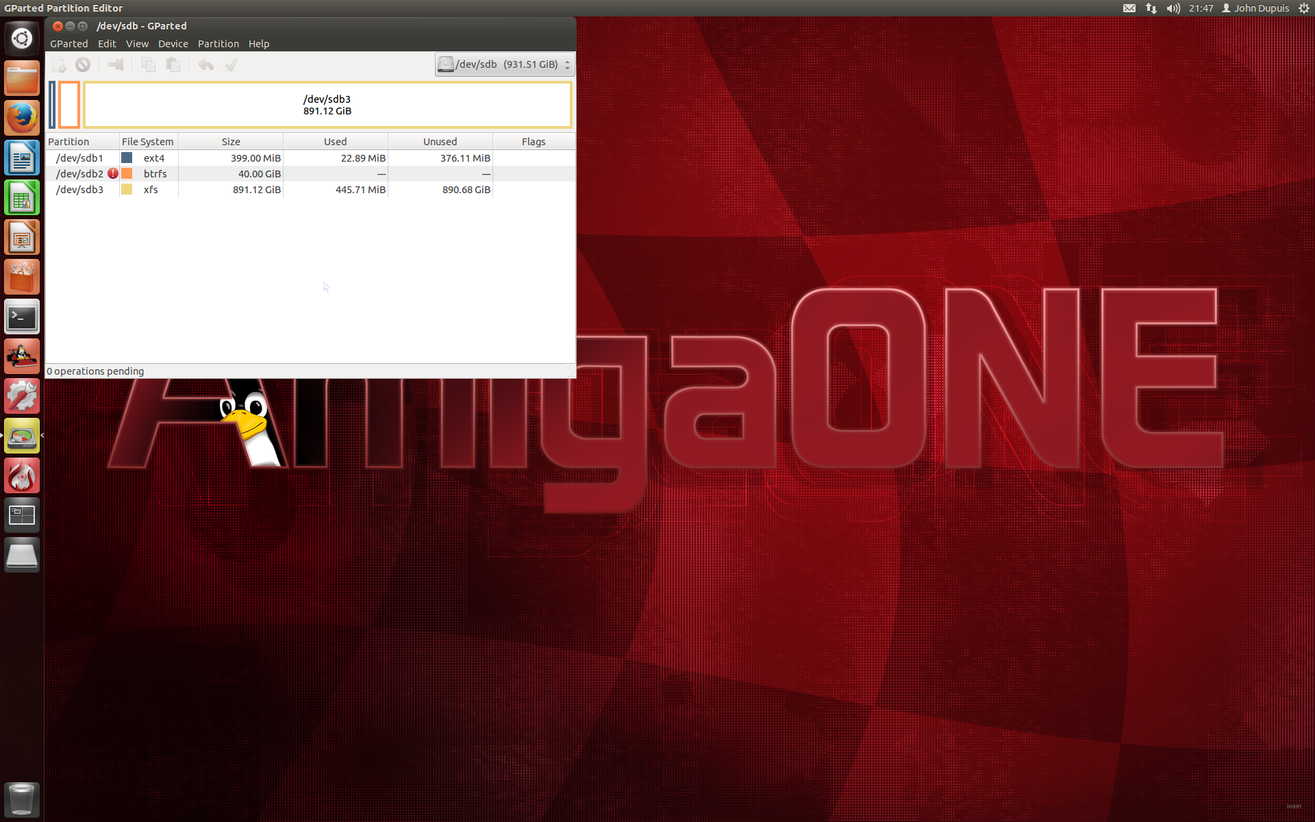

Tumbleweed DVD install with my R7 250X and using Kernel 4.6. Got the DVD to boot and start GUI installation!! :) Took a little tweaking. Will not boot up after install fro HD - Kernel panic "No working init found". Here's how I got the DVD Installation to work: Power up X1000 and insert DVD and press F
CFE>ramdisk -addr=0x24000000 -fs=iso atapi0.1:boot/ppc64/initrd [Enter] You get the fails to read error but it loads. Press "Up" arrow to re-display line and [Enter] no error
Loading.........53646964 bytes read
Entry at 0x0000000024000000
command status =0
CFE>setenv bootargs "root=/dev/ramdisk file=/cdrom/boot=boot [Enter]
command status = 0
CFE>boot -elf -noints -fatfs cf0:vmlinux-4.6 (final)
Verbose loading commences!!!! All discovered (including Realtek) :)
Network list: Shows several PWRficient Gigabyte. Choose the one with you MAC number EDIT. choose DHCP 4 and 6 NEXT
I checked Add on Repositories for test.
Initializing...
Suggested Partitioning and shows all manner of things for sdb and lists sdc5 as SWAP (created by 12.04) weird! I hit next to test default partition option. You can choose Expert. NEXT
Time Zone - don't have to explain NEXT
Warning pops up "unable to download list of repos or no repos defined. I hit OK then NEXT (for testing)
Choose Desktop (awesome) still getting somewhere in the GUI installation :)
I chose Gnome for testing but love KDE
Create Local User - New User - I checked the box Use this password for ADMIN and unchecked Auto Login
I had to NEXT through bug errors. Then it was time to restart.
CFE> setenv bootargs "root=/dev/sdb1 quiet ro splash"
CFE> boot -elf -noints -fatfs cf0:vmlinux-4.6
Loading is normal then stops at "No working init found"
"Rebooting in 180 secs
This occurs with Kernal 4.7 alpha2 as well.
Good news is I got this far and so close. I was able to boot from DVD and use Graphical Installation Environment. Now if you can repeat. This mystery init not found file may be resolved for a smoother install process. Maybe address the Partitioning part of the Installation as well. May have to modify that. I have a snap shot of the default partitions created by OpenSuse.
Cheers!!

Many thanks for testing! Well done! It's great that you was able to install it with the DVD. The init problem exists because init is on /dev/sdb2 and you boot from /dev/sdb1. Unfortunately you can't boot from /dev/sdb2 because it is a btrfs partition. Please use one partition with ext4 instead.

xeno74 wrote:Hi John,
Christian,
Not a problem. This evening I'll partition clicking on "Expert". Downloading Repositories failed as well but I'm sure can be resolved once I can get the Desktop running and configure Network and Yast in settings. During Partitioning, I'll do an /dev/sdb1 ext4 and give it and Extended Swap partition of it's own as well. I'll do the single ext4 first. One thing at a time - right?
Report tonight.
