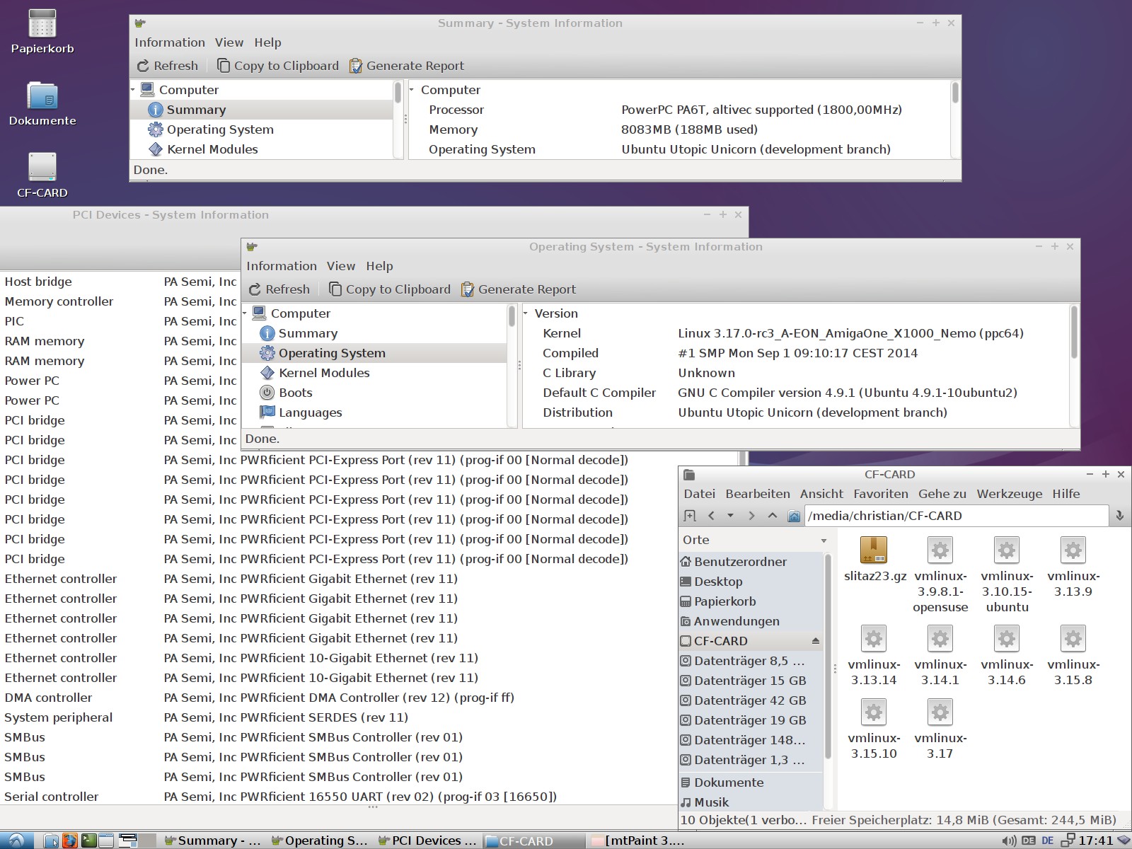

I used it with the latest 3.17 kernel RC and not only did it boot ok (the installation at first needed a couple of retries to find the ssd hard drive) it also logged on without the need of a Xorg.conf file!
On the other hand, no opengl was detected meaning no opengl acceleration. Videos work even on the web when using VLC with the viewtube script on firefox, just not using the opengl renderer. Of course 3D games as well are not working.

Evidence :D :D Screeeennnnshooottt. :-) Please try to use the unofficial Mesa for 3D acceleration.

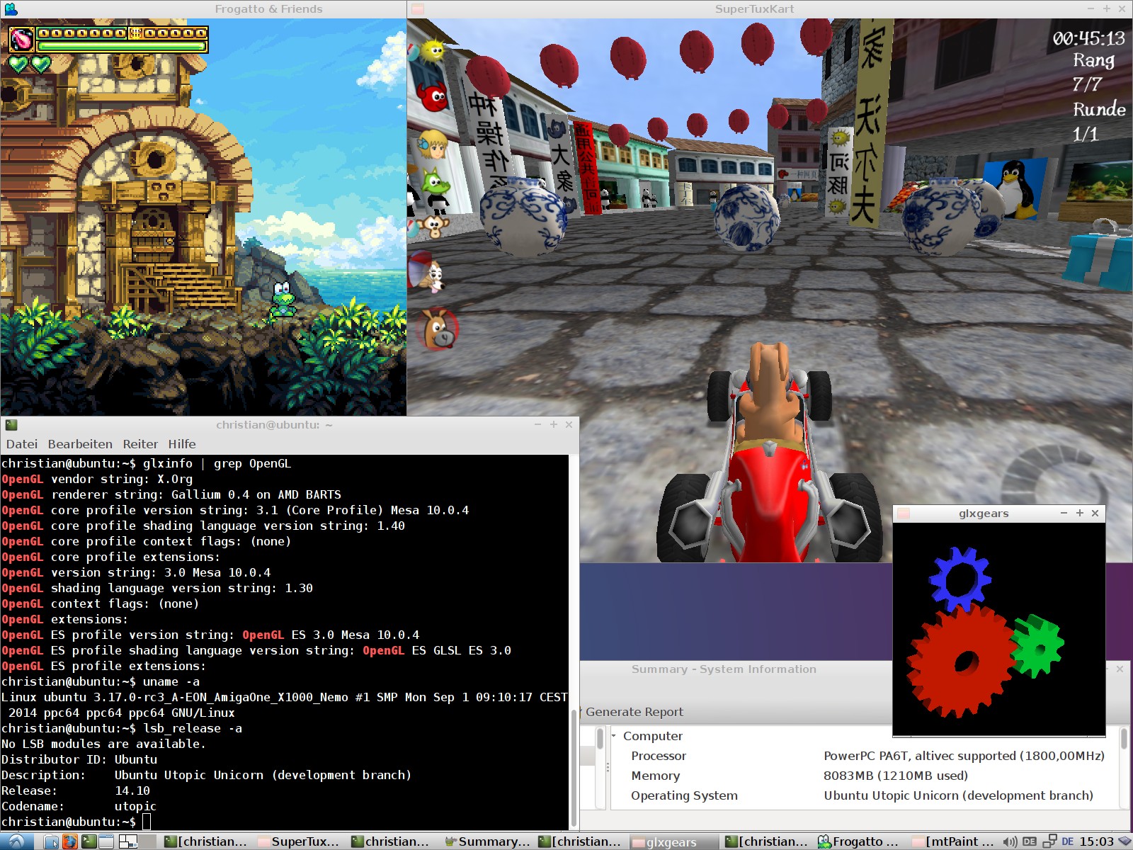

@ Srtest
You're right. 3D acceleration doesn't work. :-( And all unofficial Mesa packages don't work either.

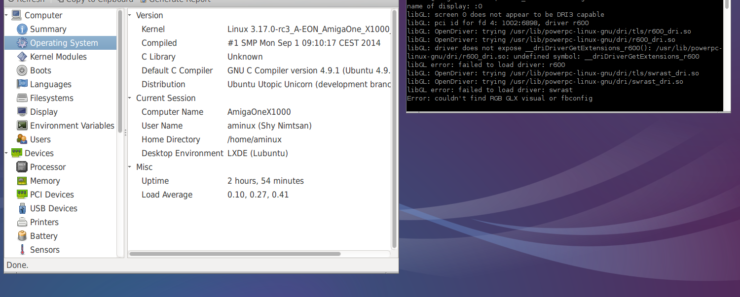

I can't say it has no 3D acceleration because for me it is not a gaming platform. I use the XVNC driver and I watch HD movies with smplayer or vlc so that is also hardware accelration in practice. If I can watch the new hobbit trailer in 1080p on youtube then what I need works. I did install some games and some of them work and some not like the supertux/never games or nexuiz. That even when not mentioning the fact hat the desktop + firefox seem to work better in this version.

LIBGL_DEBUG=verbose glxinfo
name of display: :0
libGL: screen 0 does not appear to be DRI3 capable
libGL: pci id for fd 4: 1002:6738, driver r600
libGL: OpenDriver: trying /usr/lib/powerpc-linux-gnu/dri/tls/r600_dri.so
libGL: OpenDriver: trying /usr/lib/powerpc-linux-gnu/dri/r600_dri.so
libGL: driver does not expose __driDriverGetExtensions_r600(): /usr/lib/powerpc-linux-gnu/dri/r600_dri.so: undefined symbol: __driDriverGetExtensions_r600
libGL: Can't open configuration file /home/christian/.drirc: No such file or directory.
libGL error: failed to load driver: r600
libGL: OpenDriver: trying /usr/lib/powerpc-linux-gnu/dri/tls/swrast_dri.so
libGL: OpenDriver: trying /usr/lib/powerpc-linux-gnu/dri/swrast_dri.so
libGL error: failed to load driver: swrast
Error: couldn't find RGB GLX visual or fbconfig

Kinda same :/

I have a solution for the 3D acceleration issue. :-)
Installation instructions
  1. Download the unofficial MesaLib package for Lubuntu 14.10.
    Download: MesaLib-1.0.0.4-Lubuntu_14.10-powerpc-test.tar.bz2
  2. Unpack it
  3. Install the Debian packages with the following commands:
    sudo dpkg -i libdrm-nouveau1a_2.4.52-1~precise1_powerpc.deb
    sudo dpkg -i libgl1-mesa-dri_8.0.4-0ubuntu0.7_powerpc.deb
  4. Copy the folder mesa-10.0.4 as root to the directory /usr/local/
    sudo cp -R mesa-10.0.4 /usr/local/
  5. Please, restart your A1-X1000
  6. Set up the new library path
    export LD_LIBRARY_PATH=/usr/local/mesa-10.0.4/lib/
  7. Test it with glxgears. After that you can start some games for example SuperTuxKart.
  8. SuperTuxKart needs a special run_game.sh for the new Mesa:
    LD_LIBRARY_PATH=./bin/:/usr/local/mesa-10.0.4/lib bin/supertuxkart
If you want that Mesa works system wide and after rebooting then you have to add the line export LD_LIBRARY_PATH= to the .profile file in your home directory.
Have a lot of fun with the the new unofficial Mesa. :-)

I confirm your solution works also with the 10.1.3 dri.
I don't understand - should I add
"export LD_LIBRARY_PATH=/usr/local/mesa-10.0.4/lib/"
to the ".profile" file, or,
should I add "export LD_LIBRARY_PATH="
to the ".profile" file?
