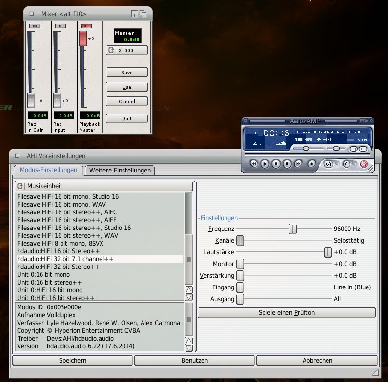

Silly question: Without using Mixer sound volume control is ok with AmigaAMP?
@tommysammy and @zzd10h:
Can you post your AHI prefs (maybe there is something different)?
Mixer/Mixer.docky BETA supporting hdaudio V6.22

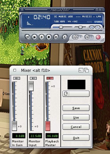

Tested the latest beta . No luck again.
I hope this screenshots give you all answer that you need

It works for me too. On Tommy's screenshot, it seems to test with mute button on (at top of the masterslider) maybe it's why it does not work for him. I know it's a beta version, but find the sound decrease when using the master slider or the docky is a bit fast IMHO compared to applicatons internal sound controller. Other sliders seem to react differently when moving them (slower)!

The 2 leftmost sliders are recording gain and recording volume.zzd10h wrote:Why are the 2 leftmost sliders at minimum ?
These will have no effect unless you are recording.

@tommysammy:
What happens if you use menu option 'Edit->Reset to default'?
Does Master MUTE work? Can you set it On/Off?
IIRC it should set hdaudio values/mutes to (left to right):
0.0dB 22.5dB 0.0dB and all mutes off (not selected)
Try to quit/exit MIXER and delete 'ENVARC:Mixer.prefs' and 'ENV:Mixer.prefs' , restart Mixer and show here slider/mutes values.
BTW: can anyone with a X1000 set AHI prefs like tommysammy has and try Mixer?
TIA
TIA

This happens when i delete ENV:Mixer.prefsjavierdlr wrote:@tommysammy:
TIA
Now i doesn`t see the X1000 soundchip
Master Mute works i can set it on/off but has no effect to my sound output
