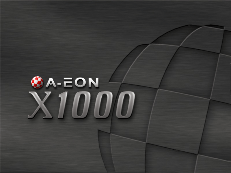

Re: Radeon HD 6850 in X1000
The latest firmware has this screen display. If you see the old A-EON logo you do not have the latest firmware installed.mbrantley wrote:Thanks for the speedy reply, Hans. My X1000 was delivered to me on June 27 and I was under the impression it had the latest firmware. However that could be a mistaken impression. I'll check and see and report back.
Trevor
- Attachments
- Early boot screen - latest firmware
- (218.5 KiB) Downloaded 3184 times
Thanks, Trevor. I definitely do not have the latest then. Just found my version is PAS-2.0.30. Off to A-Eon site to download latest and install instructions.
