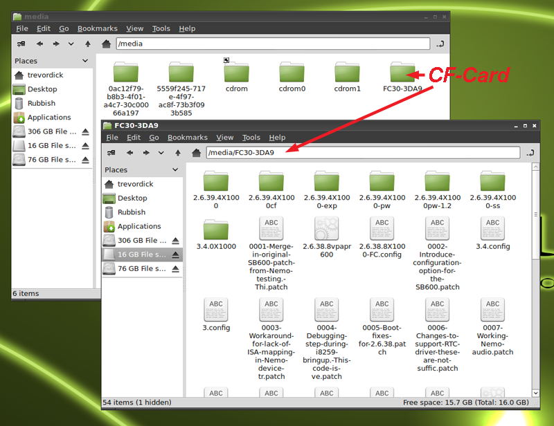

The disk labeled Linux is the CF card I keep my linux kernels on (In the CF slot), Thanks to the help of LyleHaze, I've managed to add it as a platform_ata device.
This kernel is based on 3.4.0, and is not ready for release just yet, as I seem to have added a interrupt initialisation problem which causes it to hang during boot quite a bit. I am investigating. Annoyingly it works well when it boots.

trevordick wrote:Thanks Darren, I look forward to adding your latest work to the Installation guide. Excellent news re the CF card. It means I won't have to remove the card and place it in a USB card reader to copy new kernels and files to it. :-)
I've taken a break on the 3.4.0 at the moment, I think i'll need a lot of time to find the problem, however I have copied my changes back to the 2.6.39.4 source and built a new kernel.
Some info:
I used Pats vmlinux39pw-1.2 config, and added the cf patch so this should work with Debian, Mint and Ubuntu.
The modified file "pata_of_platform.c" is included, and lives in drivers/ata, just replace the current one with mine new one.
Note: Gnome mangles the drive name, (endiness problem) but it reads and writes OK
Report any problems!

BTW I tested your vmlinux39cf kernel and pleased to say the internal CF card was accessible. :-)
I even copied the /lib/modules from cf0: after booting with the new kernel for the first time. Picture attached of CF card and directory in MintPPC.
Good work Daz! :-)
Internal CF card now accessible from Linux
(252.28 KiB) Downloaded 2144 times
