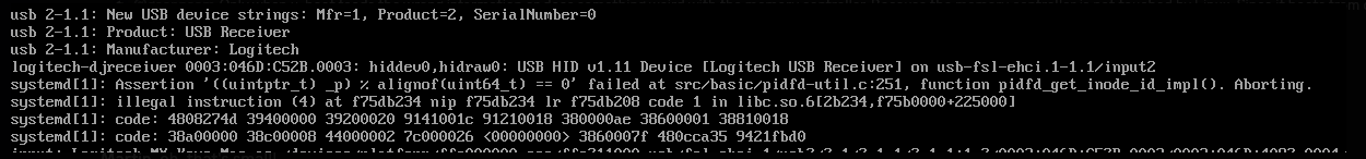

I just updated my packages (sudo apt-get update, sudo apt-get upgrade) and now I cannot boot linux anymore.
Any chance of recovering from this?
X5040, Mint on sda4, kernel (6.15) and DTB on the SD card.
I was going to ask if there was anything more involved in updating this setup since the kernel and linux-image don't seem to match versions but this error beat me to the question!

MartinW wrote: Thu Aug 14, 2025 11:31 pm I just updated my packages (sudo apt-get update, sudo apt-get upgrade) and now I cannot boot linux anymore.
Illegal instruction from a new version of libc.
Libc send an instruction, that our e5500 CPU doesn’t understand.
Maybe the Debian developers have compiled the libc with AltiVec support or with instructions from a newer POWER CPU.
