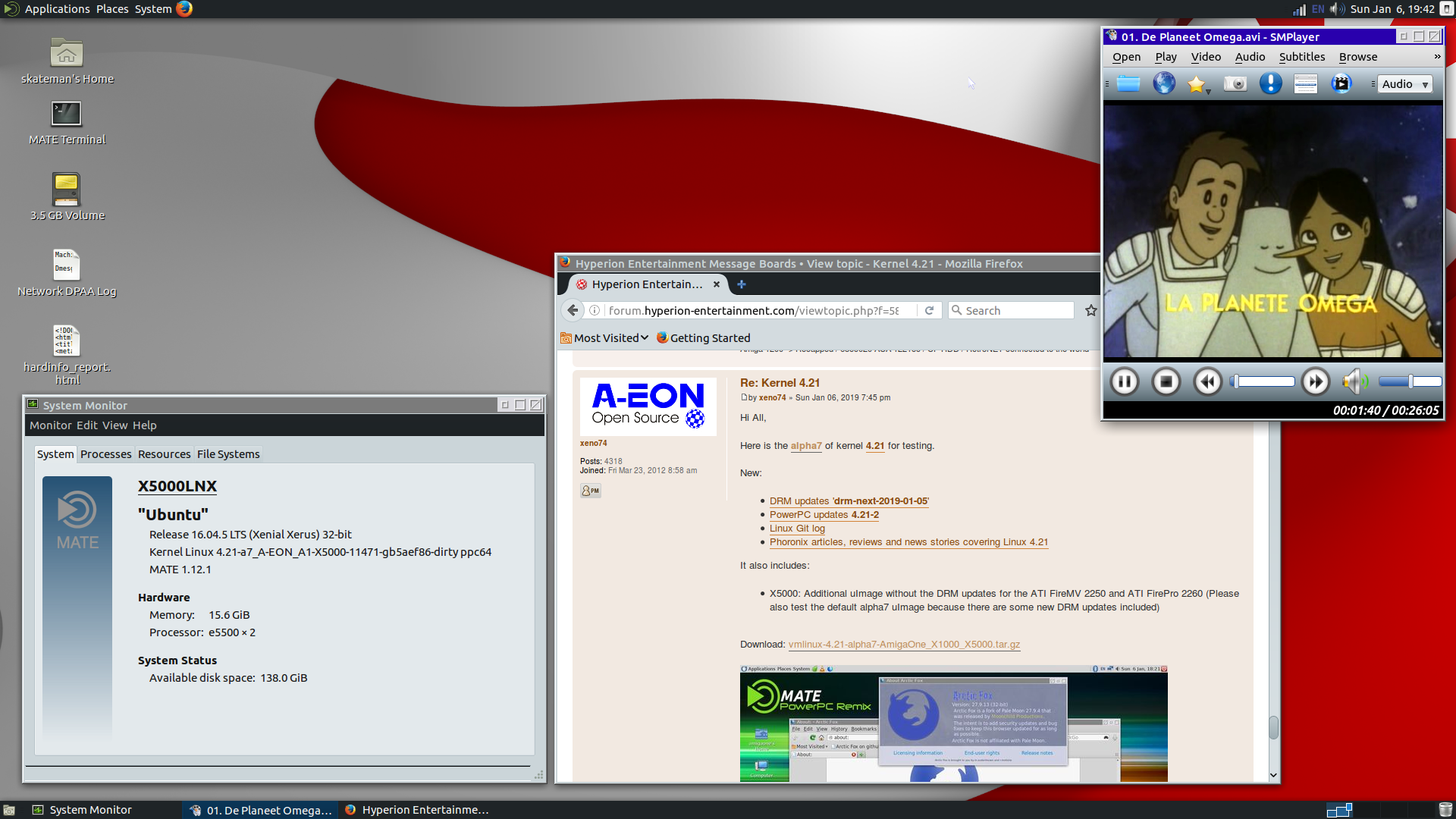

Alpha 7 Up and Running!! :-)
Big picture http://www.skateman.nl/wp-content/uploa ... 194203.png
