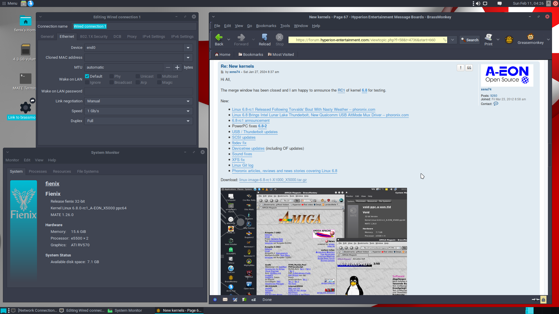

Kernel 6.8 RC1 up and running fine on my AmigaOne X5000
Big picture: https://www.skateman.nl/wp-content/uplo ... -26-08.png
For the X5000 users who might have issues with the onboard NIC, you could try to use the manual negotion settings as shown in the screenshot.
Posts: 938
Skateman wrote: Sun Feb 11, 2024 11:30 amFor the X5000 users who might have issues with the onboard NIC, you could try to use the manual negotion settings as shown in the screenshot.
For curiosity, I tested those settings, but the the 'unplug-replug' issue is still present :-(. This is the 'longest-term-bug' I ever have seen in Linux kernels...
Posts: 975
I agree that its a very strange issue..,, too bad the negotiation speed settings did not help.

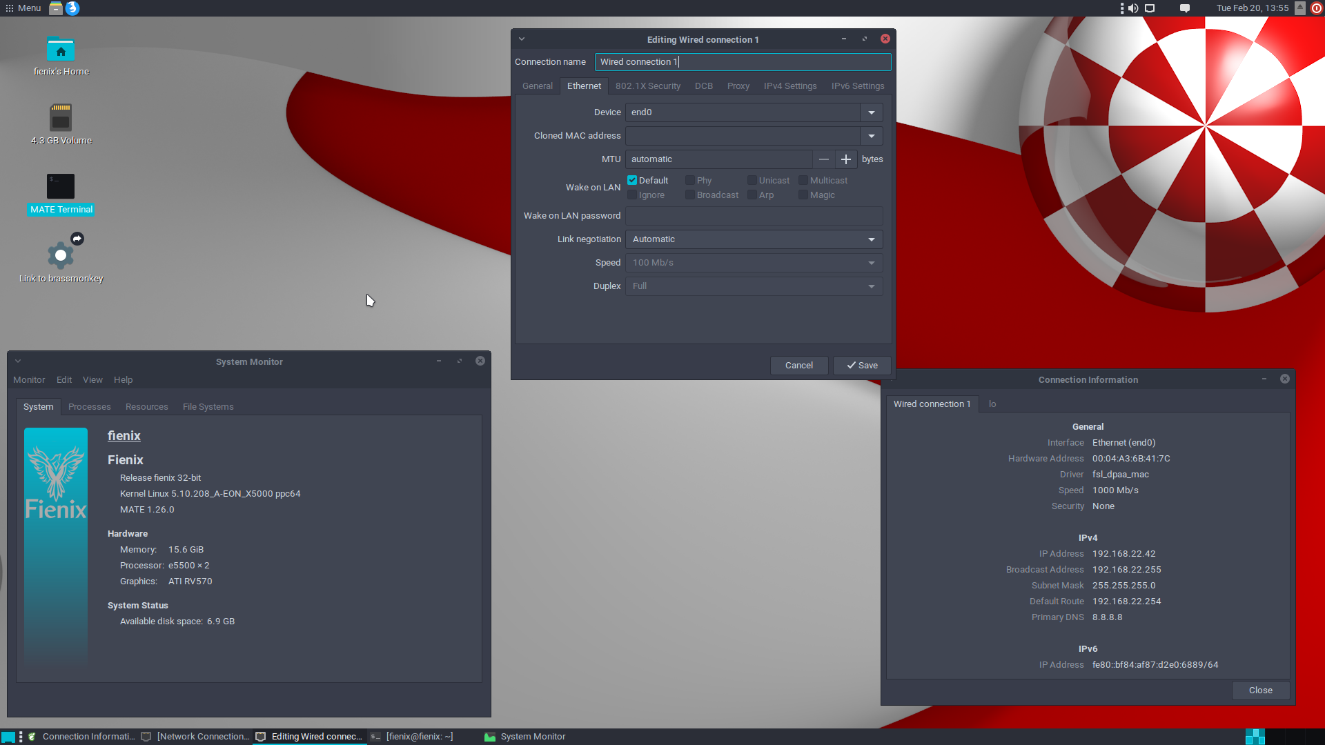

Posts: 975
Stable kernel 5.10, DPAA negotion speed set to Automatic, and no issues!
Big picture https://www.skateman.nl/wp-content/uplo ... -55-26.png
