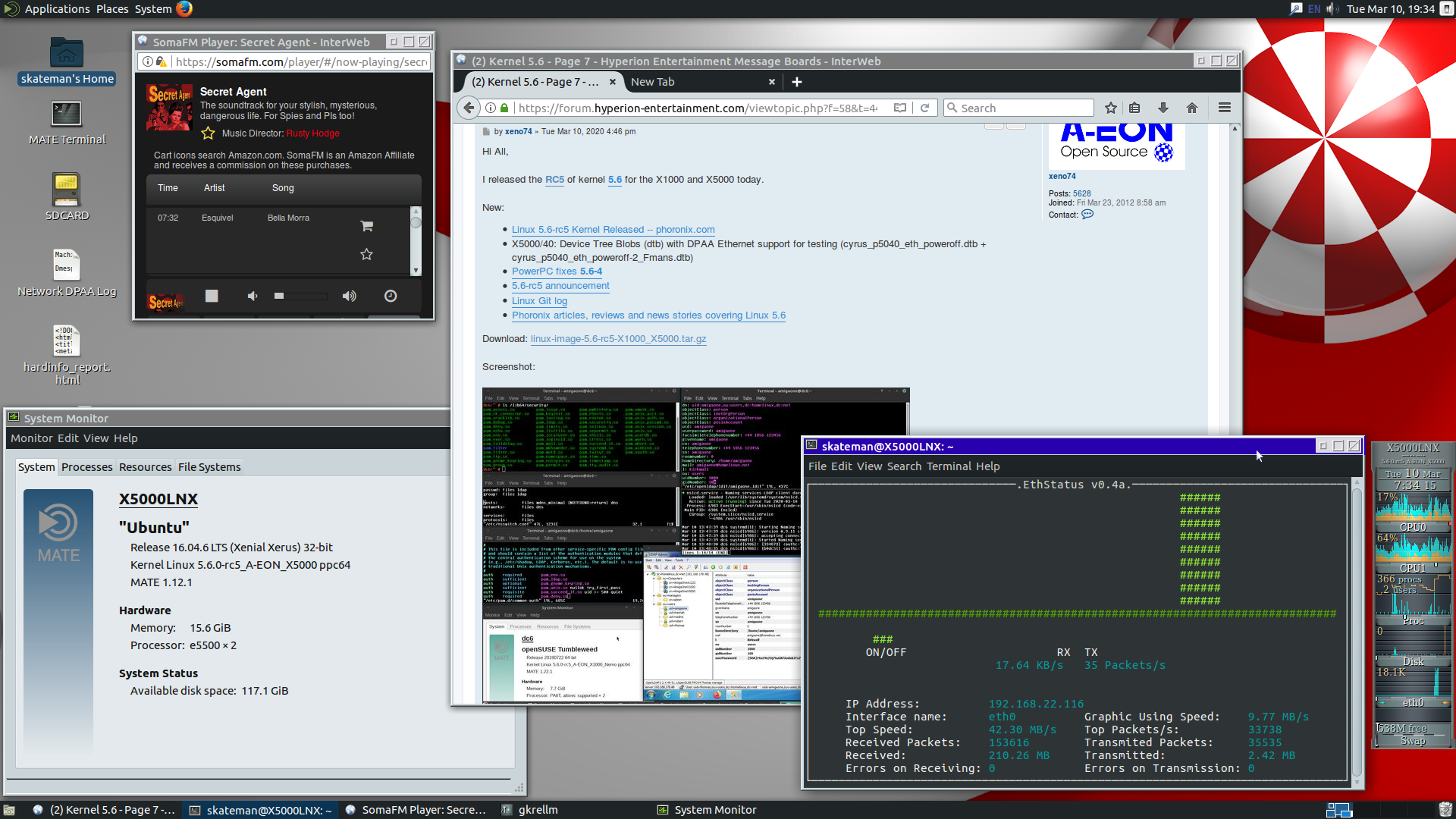

Posts: 965
Re: Kernel 5.6
Kernel 5.6 RC5 is running great on the AmigaOne X5000 with working DPAA Ethernet adapter!
Big picture http://www.skateman.nl/wp-content/uploa ... 193415.png
