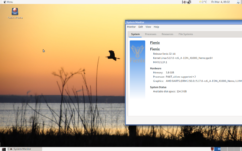

Hi Christian.
Kernel 5.17 RC6 boot Fienix 5 without problem.
and Repository is working again Thanks to casey
Have a nice day

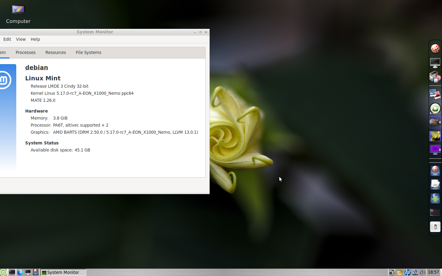

HI
Kernel 5.17 rc7 working here with Mint 32 bit
Have a nice day
