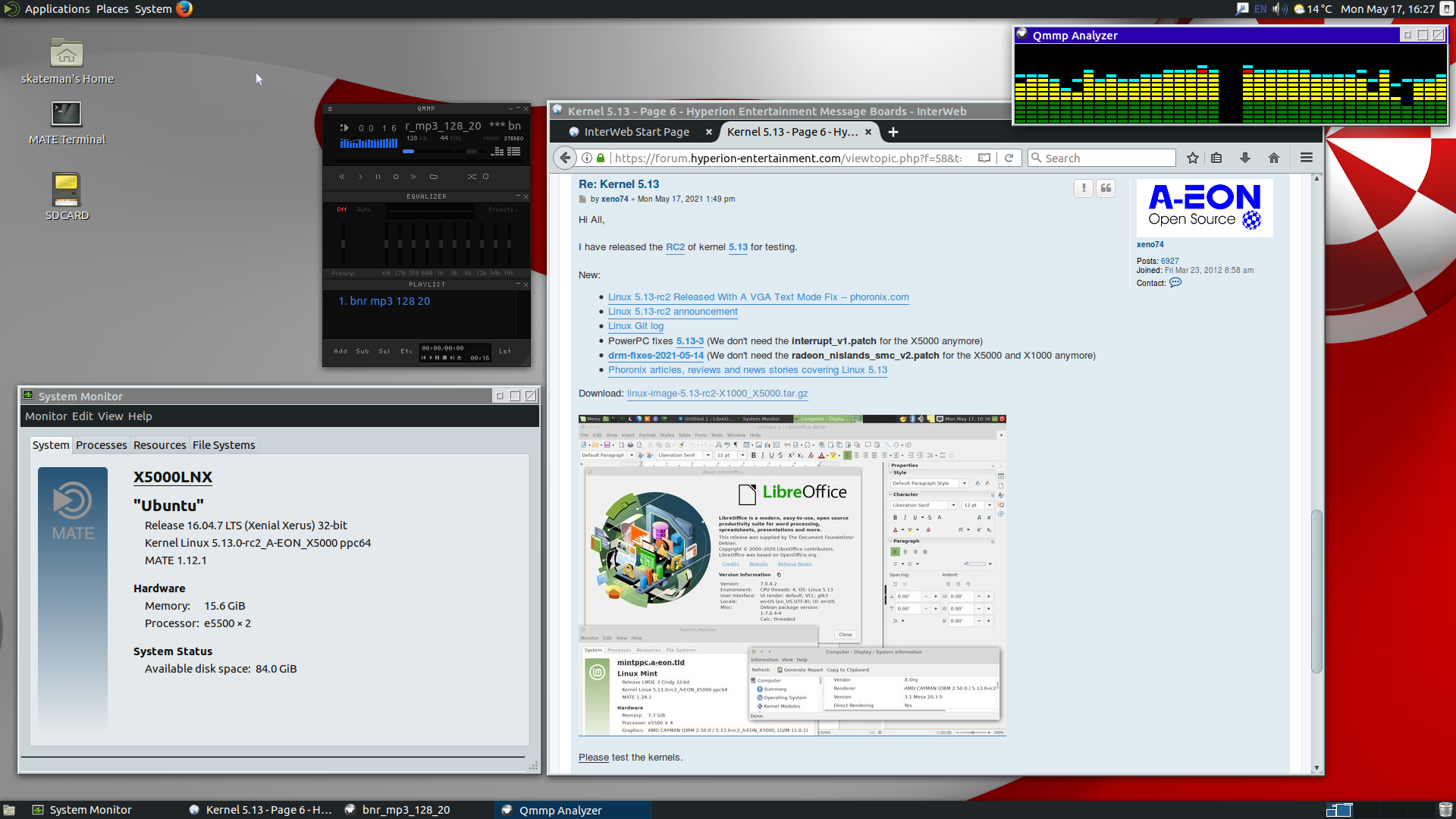

Posts: 968
Re: Kernel 5.13
Kernel 5.13 RC2 is up and running on my AmigaOne X5000
Big picture http://www.skateman.nl/wp-content/uploa ... 162745.png
Posts: 11102
Re: Kernel 5.13
Skateman wrote: Mon May 17, 2021 2:30 pm Kernel 5.13 RC2 is up and running on my AmigaOne X5000
You're fast. Great! Thank you!
