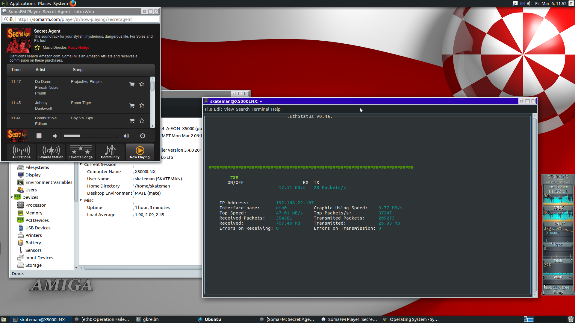

Just to know for sure... i have been using the X5000 RC4 with DPAA Ethernet for 1 hour 30 minutes. There has been flowing a few hundreds of megabyte through the adapter with no issues at all. Lets figure out where what goes wrong with the other users.
Big picture http://www.skateman.nl/wp-content/uploa ... 115238.png
