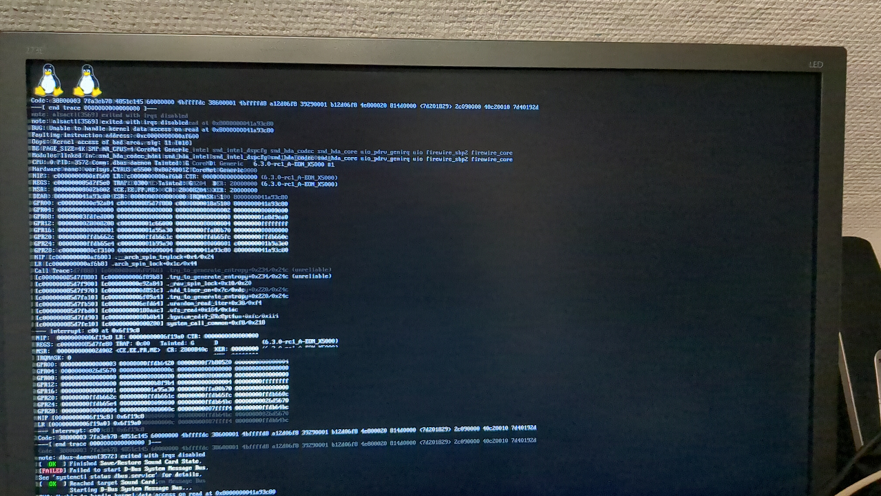

Kernel is not working on my X5000.
After the kernel loads this happens... https://www.skateman.nl/wp-content/uplo ... 407428.jpg
Video.. https://photos.app.goo.gl/fUjS5rjuAUkdRW929
Looks like its expecting 4 cores ???? (if i can make anything out of the dump onscreen)
Posts: 11438
Thanks a lot for testing the RC1!
Could you also please test the alpha3 with the first PowerPC updates? Maybe the issue is in the first PowerPC updates.

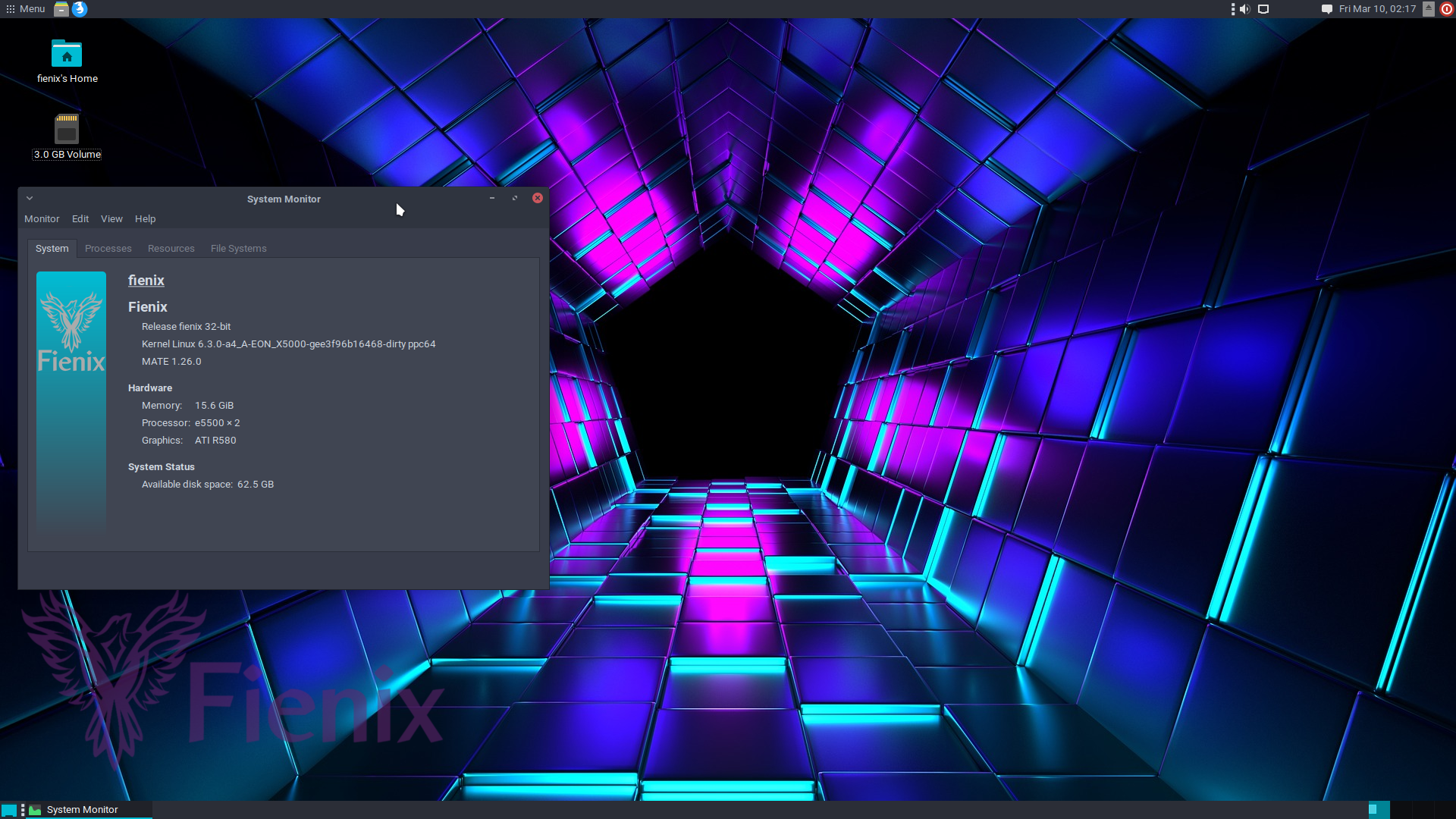

Hi Christian,
Tested Alpha4 of Kernel 6.3 and this is working ok!
Big picture https://www.skateman.nl/wp-content/uplo ... -17-36.png
Posts: 11438
Thank you for testing the alpha4.
Maybe this is the problematic commit: cpumask: re-introduce constant-sized cpumask optimizations
As the commit holds stuff like CPU_NRS etc.... and the stuff i am seeing at boot i would say Yes... this is the problematic code.

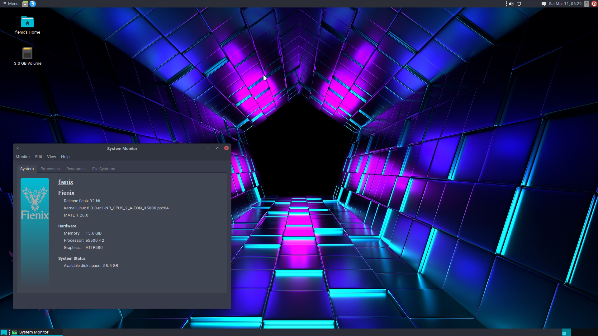

Good morning Skateman,
Could you please test the two following kernels?
Posts: 11438
xeno74 wrote: Sat Mar 11, 2023 9:37 am Good morning Skateman,
If they don't work, please delete the RC1 kernel modules and test the both kernels again.
NR_CPUS_2 is working fine!
Big picture https://www.skateman.nl/wp-content/uplo ... -29-21.png

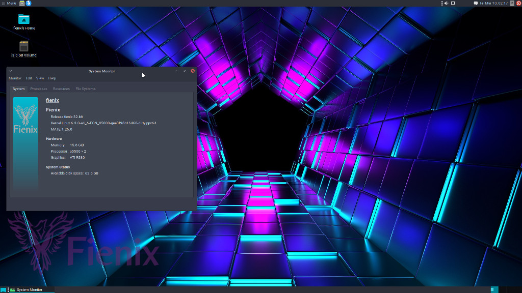

FORCE_NR_CPUS_2 is also working fine
Big picture https://www.skateman.nl/wp-content/uplo ... -36-41.png
