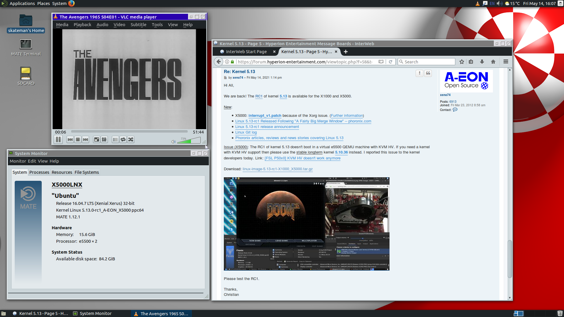

Posts: 980
Re: Kernel 5.13
Kernel 5.13 RC1 up and running on my AmigaOne X5000
Big picture http://www.skateman.nl/wp-content/uploa ... 160750.png
Thank you for all the hard work that was needed to bring us RC1....
Posts: 11492
Re: Kernel 5.13
Skateman wrote: Fri May 14, 2021 4:10 pm Kernel 5.13 RC1 up and running on my AmigaOne X5000
Thank you for testing the RC1! :-)

Re: Kernel 5.13
Imagine that! Kernel Linux 5.13.0-rc1_A-EON_X5000ppc64 up and running!
