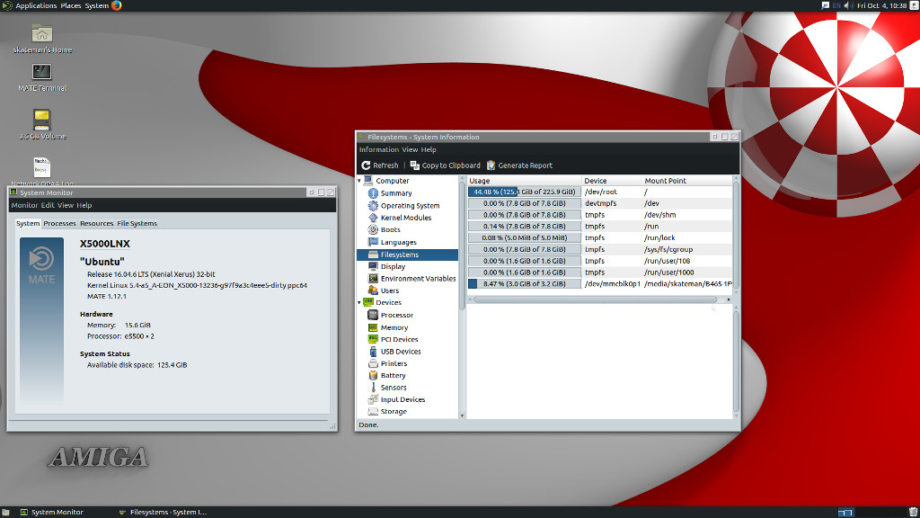

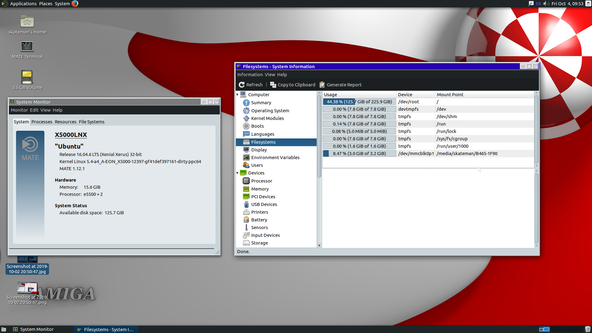

HI Christian,
With 5.4 Alpha 4 /dev/mmcblk0p1 does get automounted at systemstartup.
Since i am using the SDcard (/dev/mmcblk0p1) for the kernel files i would prefer it to be mounted at system startup
Big picture http://www.skateman.nl/wp-content/uploa ... 095352.png

Skateman wrote: HI Christian,
Thanks a lot for testing the alpha4! Could you please test the alpha5 as well?

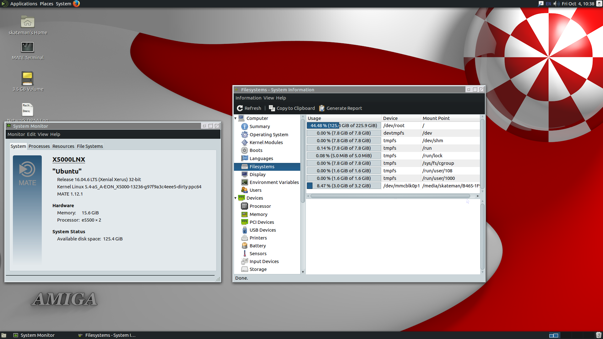

Posts: 965
Re: Kernel 5.4
HERO!!! You fixed it ... again :-)
Big picture http://www.skateman.nl/wp-content/uploa ... 103821.png
Posts: 10931
Re: Kernel 5.4
Skateman wrote:HERO!!! You fixed it ... again :-)
I didn't fix it. The issue is between the alpha5 and the RC1. Please test the RC1 again and post the output of "dmesg | grep -i mmcblk0p1.
