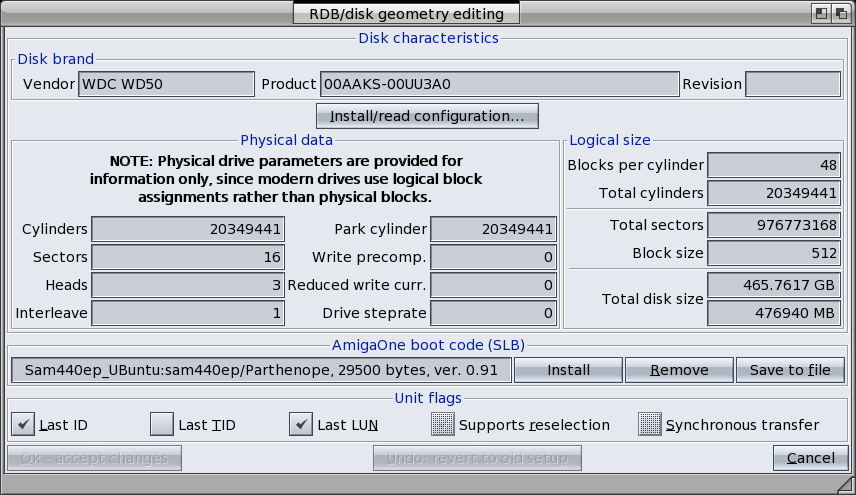

Parthenope is the supported boot loader. included on the Sam installer ISO's.(Parthenope is the older version and u2lb is the newer version).usage u2lb for Sam460ex machines and parthenope for Sam440ep machines
This you have to manually install via AmigaOS 4.1 .
Your AmigaOS boot partition must be SFS/00 to boot using Parthenope

Parthenope
(67.94 KiB) Downloaded 254 times

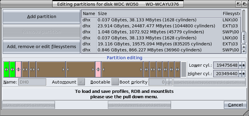

Free Space on Harddrive
(69.08 KiB) Downloaded 254 times

Posts: 1538
Select your empty space in Media toolbox and click on Add partition.
For the Emergency boot partition add 87,363 to the Lower cyl value and type the result into the Higher cyl box.
You can do the same thing for the extra rootfs partition but using a higher number eg 835,204 for a 19GB partition.
Whatever free space is left will be used for Linux by the Linux installer
