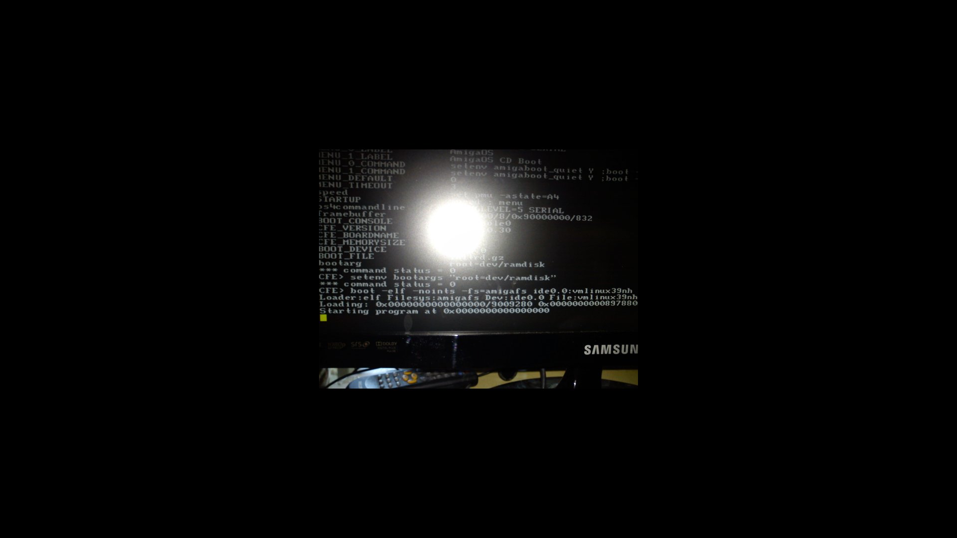

Hello.
I have a litte trouble to install linux on my X1000.
Using an usb stick with fat that holds the kernels.
I Followed the instructions but after boot the kernel
it shows "Starting...." and then hangs.
I try all the different kernels.
Anybody have a hint?
P.S.: Other topic. I also have registered (twice, first a week ago) on Aeon website and receive no mail :(

I try it also loading the kernel from the boothd with amigafs.
Yes, i use the cd to load the initrd.gz from it.
This is what happens....
(77.86 KiB) Downloaded 2213 times

Re: NEW Debian/Linux Installation Guide version 2.1
Post by TearsOfMe »
TearsOfMe wrote:I try it also loading the kernel from the boothd with amigafs.
P.S.: the root=dev/ramdisk was an test, i try also with root=/dev/ramdisk

I think you have to use at fat usb disk to your kernel
here is what i use
CFE> ramdisk -z -addr=0x24000000 -fatfs usbdisk0:install/powerpc64/initrd.gz /copy initrd.gz from cd to usb)
CFE> setenv bootargs "root=/dev/ramdisk"
CFE> boot -elf -noints -fatfs usbdisk0:vmlinux39NH
Remember uppercase and lowercase letters

Reformat the stick and copy the initrd to it and now it works !!!!
Posting this from my litte sam440 while install is going on...
