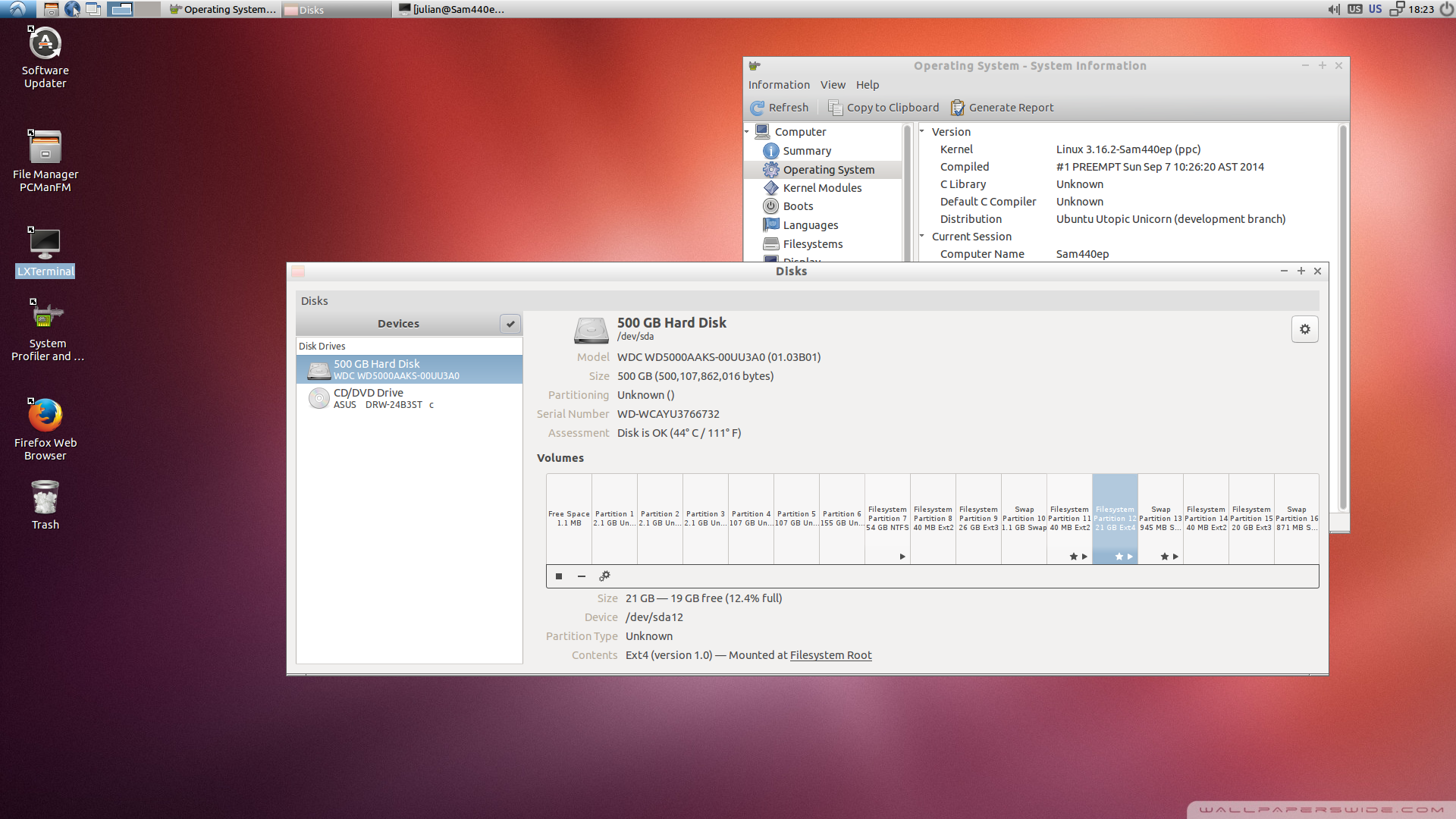

Lubuntu 14.10 Installed from scratch with my new ramdisk .
New ramdisk defaults to Ext4 for root Filesystem.

It Is not that I dont want too but it is getting harder without being able to test.This includes the ramdisks for the installers as there is a size limitation.
You can have several seperate Linux installations on the first hard drive once the total number of partitions including the linux ones does not exceed 16 .
I have 3 installations at a time.The trick is get the bootstrap to point to the correct root partition before rebooting the installer. except for the installation using the last partition.
You can do this by starting a shell from the installer options before it reboots. whn the installation is done select go back instead of rebooting.
You will get the menu options inculding start a shell .
Then edit the menu.lst file and make sure that it points to the right system partition . so if there are 7 partions before the 3 linux ones for this installation then the system partition
is sda9 (7+2).you have to make sure you know how many partitions you have before starting the installation.
So in the shell
nano /target/boot/menu.lst
Then change the root=/dev/sdaX
to root=/dev/sda9
save by typing contro+X and the pressing y to save.
type quit and enter to exit the shell.
then select the option to finish the installation
