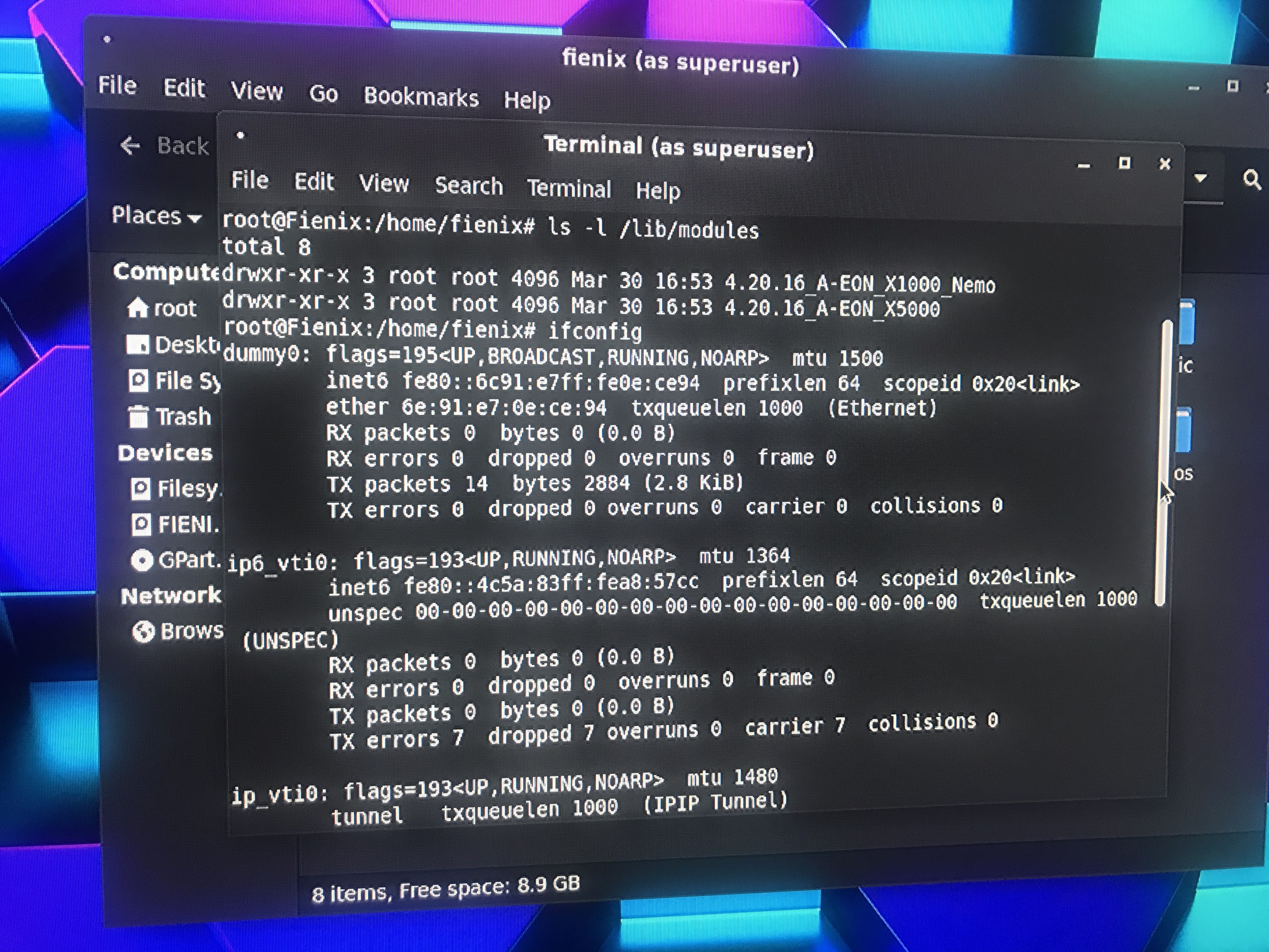

For now there is no working support for the onboard Ethernet adapter within the Kernel versions used. (so thats the DPAA with the Red errors)
As i can see, it looks like you have an Intel pro 1000 Nic which does get probed, and a Realtek NIC. Is this correct? do you have two Ethernet adapters installed ?
What is the output of Ifconfig ? You should have something like an ETH0 and ETH1. Otherwise try the command, ifconfig eth0 up
Posts: 11246
Tijatjj wrote:Alright this is what it’s saying but using the add on Ethernet do no know if there is a driver for the Ethernet for the x5000
Tijatjj,
Please post the output of ls -l /lib/modules.
Tijatjj
Posts: 159
Post by Tijatjj »
Here it is thank you
