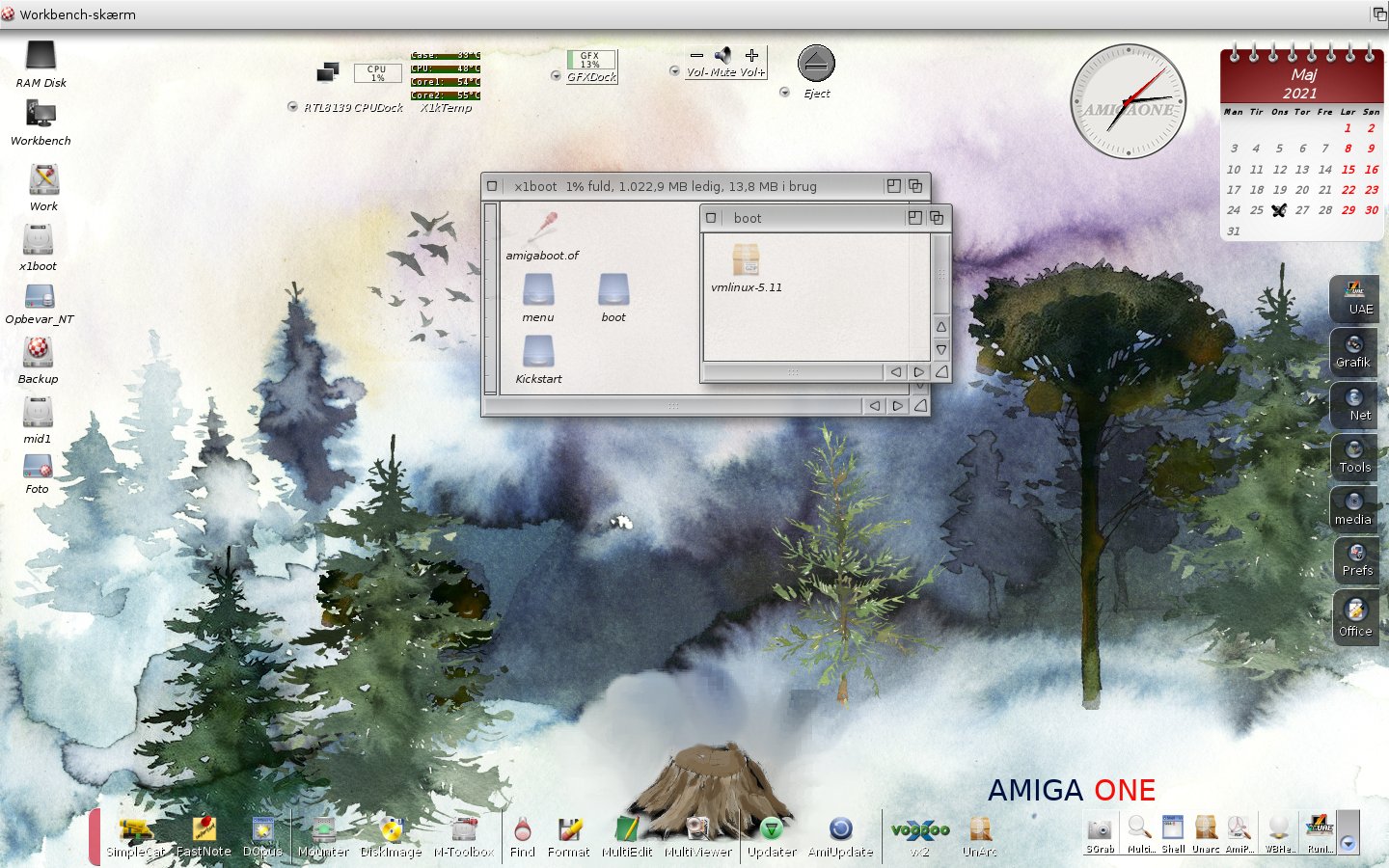

this is the setup of the my x1boot partition .
Your partition looks fine. If AmigaBoot can see it then the format is fine. What does the x1boot:boot/ folder looks like with installed kernels?

Here is folder x1boot/boot

musa wrote: Wed May 26, 2021 7:17 pm Here is folder x1boot/boot
By the way what parameters is your x1 boot partition formatted. International, long filenames?
Peter
That looks fine from here. This isn't mentioned but to load from AmigaBoot and indeed CFE the kernel size is limited to around 15MB or so like the old UBoot. It's only a FFS limitation AFAIK because you can load 30MB off FAT. But for some reason the FFS driver in CFE is crippled. In any case CFE also uses slow PIO mode so it's best squash it down. :-)

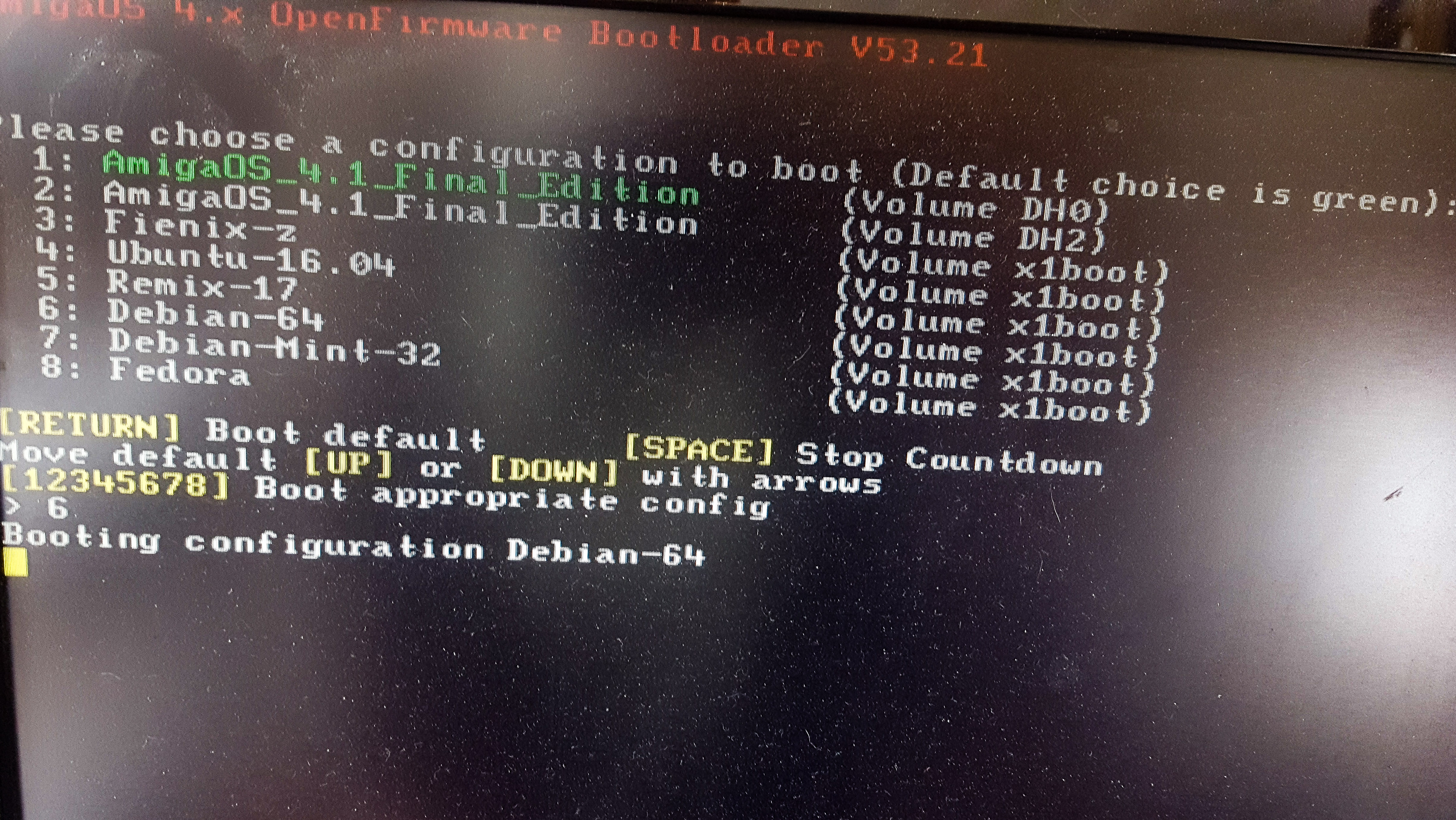

Re: Presenting the X1Boot Manager!
Hi
Here is my amigaboot menu with new linux boot menus
Have a nice day
Peter

musa wrote: Thu May 27, 2021 6:10 pm Hi
Wow cool. You've really set it all up. Hope they all boot! :-P
It must look strange seeing Linux entries in an AmigaBoot menu. :-D
