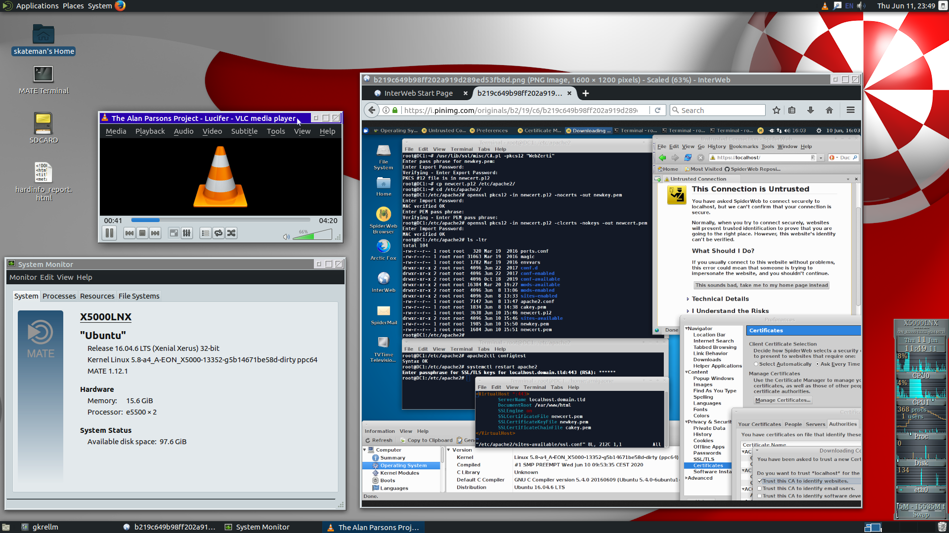

Kernel 5.8 Alpha1 up and running on the AmigaOne X5000/20
Big picture http://www.skateman.nl/wp-content/uploa ... -48-32.png

Skateman wrote: Mon Jun 08, 2020 9:53 am Kernel 5.8 Alpha1 up and running on the AmigaOne X5000/20
Many thanks for testing the alpha1! :-)

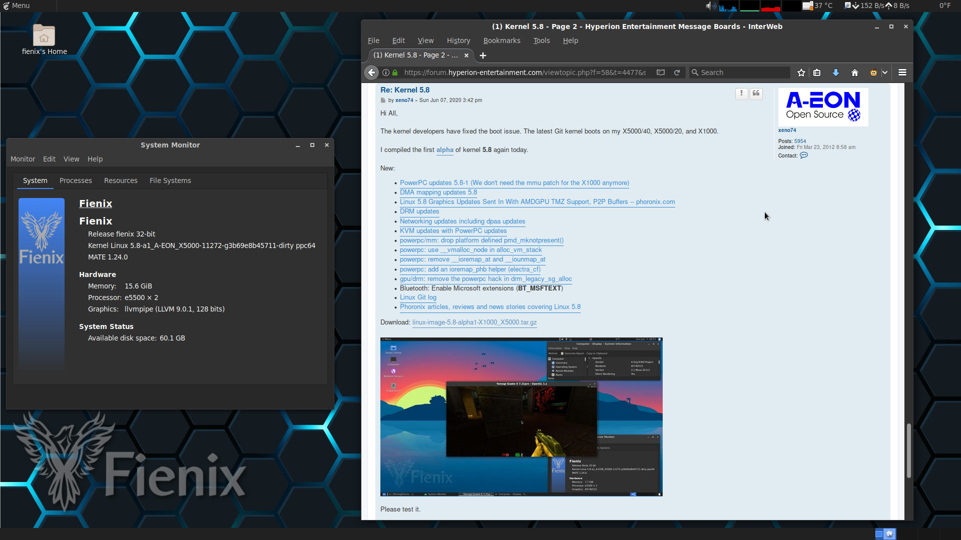

I released the second alpha of kernel 5.8 for the X1000 and X5000 today.
Download: linux-image-5.8-alpha2-X1000_X5000.tar.gz

Here is the third alpha of kernel 5.8 for testing.
Download: linux-image-5.8-alpha3-X1000_X5000.tar.gz
I tested QEMU 2.5.0 and QEMU 5.0.0 with KVM and KVM-PR today. KVM works without any problems. I was able to boot a Fienix guest with the alpha3 in a virtual e5500 QEMU machine with KVM on a Fienix X5000 host with the alpha3. (see screenshot)

Kernel 5.8 Alpha 4 running nice on the AmigaOne X5000
Big picture http://www.skateman.nl/wp-content/uploa ... 234911.png
Posts: 11415
Re: Kernel 5.8
Skateman wrote: Thu Jun 11, 2020 9:51 pm Kernel 5.8 Alpha 4 running nice on the AmigaOne X5000
