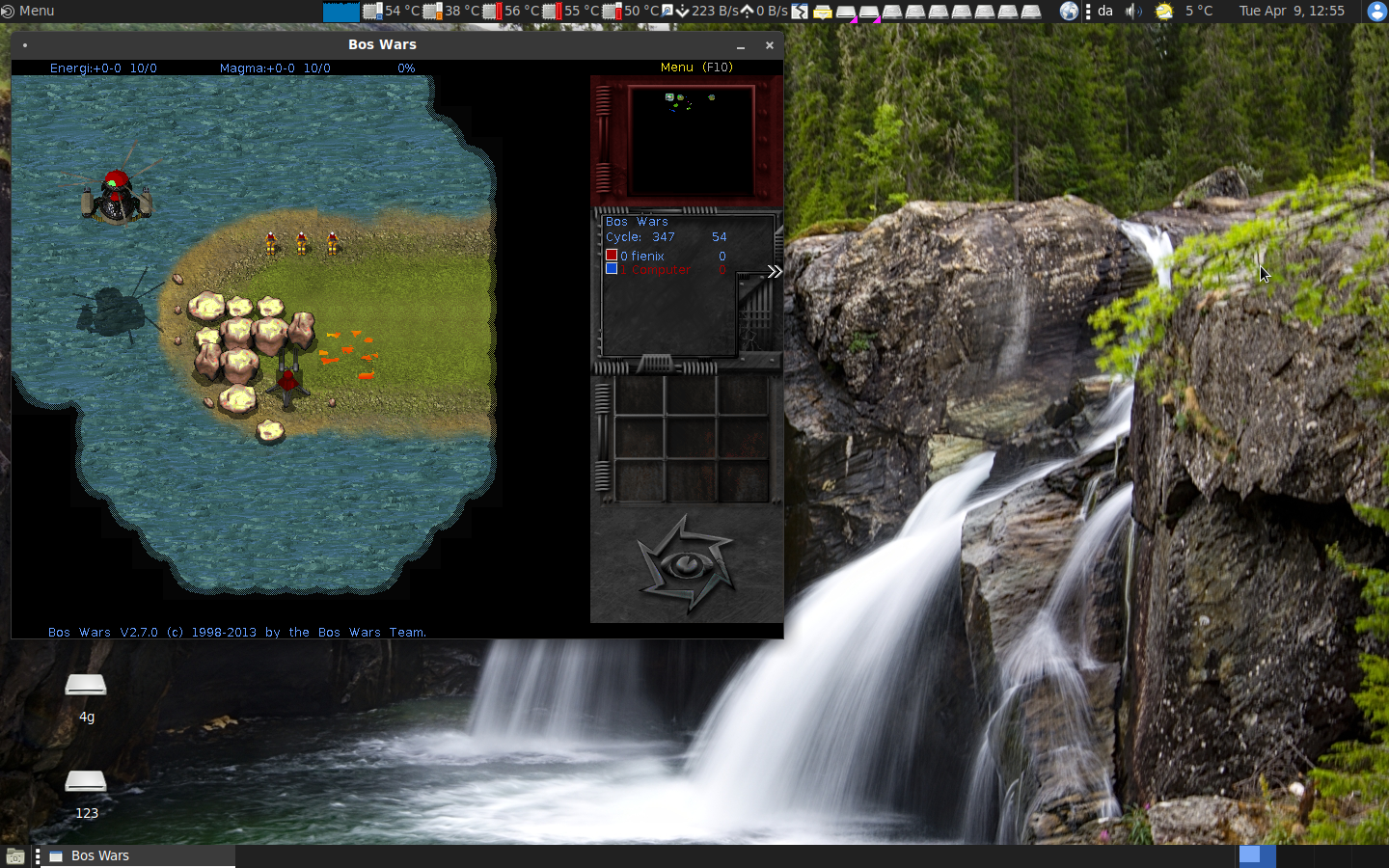

[One question. Can you use the glxgears command.? I got a segmentation fault.
Posts: 10902
musa wrote:[One question. Can you use the glxgears command.? I got a segmentation fault.
Yes, it’s working. (see screenshot)
